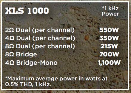

Thanks Dave.  This is good info.  Can 2 guitarists use one crown power amp and feed it into two different 2x12's or two passive speakers?  Would like to use it with the other guitarist on the band to lighten up the load.
I am also looking into using guitar speakers instead of the passive FRFR. Do you think using the Eminence Governor or the V30's will sound good?
Yes you can run each side independently. I'm attaching a jpeg, we'll see if it works. the output you'll get will depend on the speaker ohm ratings. Most are 8 ohm, but some are 16. With 2 speakers per side, I'd choose 8 ohm speakers to give a paralleled load of 4 ohms. Make sure the total wattage rating of your speakers are adequate. You will appear to get about half the wattage of the amp rating. I spoke about that above with SS amps compared to tube amps (at least in my experience).
Speaker choices are all a matter of taste and adjustment. I finally went with FRFR speakers because I found using full models in Studio mode, the modeled amps & speakers through midrange heavy guitar speakers over-accentuated the mids, and found it hard to compensate... YMMV.
Dave
Dave
So, the max rating in each 2x12 should be 500 watts right?  Sorry, I'm not really good at this.. :D
Yeah, that'd do, but the amp is rated at 350 Watts each side into 4 Ohm load. Would mean you'd need each 8 Ohm speaker to have a max rating of 175 Watts...  The Tonker is rated 150 Watts, 2 of those would give your cabinet 300 Watts (if not the Tonker, then some other in that range -- again taste in speakers varies). Your 2 - 12's would need to be able to handle ~ 350 Watts peak, if you run full bore open. Most speakers are rated at "RMS" or "Program" with "Peak" at about 2X "Program" -- meaning short bursts of peak power.... Speakers are a bit of a "dark art"....
My Tonkers are rated 150 Watts each, my Beta 12LTA's are rated 225 Watts each.... Those are "Program" ratings. Theses speakers retail under $100 each....
Dave
