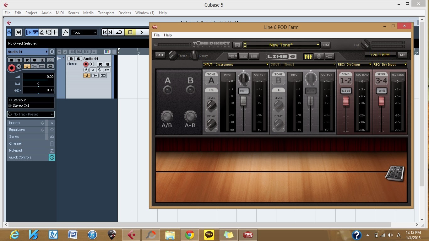

darrenkim Posted January 4, 2015 Author Share Posted January 4, 2015 Your clipping somewhere really bad for sure. Can you explain exactly your set-up, the programs your using, guitars, and how your routing it all. Maybe even a screen shot or two or three of anything you might think may help you and others with this same problem. Are you are you plugging into the PAD on the UX2? It's unlikely your UX2 is broken, but not impossible. These units are pretty tough and either tend to last forever or peter out rather quickly. Thanks for the reply, My set up is... 1. Guitar - UX2 (normal instrument input) - PC [Pod Farm 2 and Cubase 5] I have a question - Do I always have to use Pod Farm 2 with UX2?) 3. Guitar - Amp (Blackstar HT-5R) - Emulated Output from my amp - Line 1/L input on UX2 - Pod Farm 2 - Cubase 5 However, I want to bypass the Pod Farm 2, so I have nothing on Pod Farm, just the mixer. I've recorded videos of the problems I am facing http://www.youtube.com/watch?v=reHcqN67zDs&list=UUuXrKSn0sXoJHWK0bfqN3QQ&index=2 as you see, every note only lasts a second.. though it's still ringing on my guitar! dB level on UX2 drops and the note's dead. http://www.youtube.com/watch?v=vPX-1kJGbik&list=UUuXrKSn0sXoJHWK0bfqN3QQ&index=4 When I play notes lightly, the dB level doesn't go up on my UX2 and nothing gets reccorded. If I play a bit harder, then the dB shoots to the max. (and is really distorted in recording) When I bend notes, it cuts it off; the note is still sustaining on my guitar but in the recording, it just cuts off after a second. There's no sustain. http://www.youtube.com/watch?v=qmQCi04NYIs&index=1&list=UUuXrKSn0sXoJHWK0bfqN3QQ What does the output knob do? doesn't it control the dB level? the dB level still goes up when I have the output on 0. The recording still works too. What I thought was that, the output is 0, so nothing should be recorded. Please correct me if I'm wrong. Quote Link to comment Share on other sites More sharing options...
darrenkim Posted January 4, 2015 Author Share Posted January 4, 2015 Please provide more information about your setup. - what are the various instruments and devices are you using and how are they connected? - what computer system and recording program are you using? What audio device and driver is your recording program configured to use? - are you using a very 'hot' guitar setup (active pickups, hot humbuckers, pickups close to strings, ...)? - what happens to your recording when you turn down the volume knob on your guitar for recording? Hello, thank you for your reply I just posted my gear and setup. I run Cubase 5 or the Ableton Live (that came with my UX2) on windows 8. And no.. no active pickups hot humbuckers anything. so I have it connected to normal instrument input. Oh one strange thing.. I tried lowering the volume on my guitar as you said. It only records (and gets distorted) when volume is on 10. lower than that, like 4,5, nothing gets recorded. volume 9 or 8ish just gets me really compressed sound in tiny tiny volume. then on 10, boom! PS. I tried re installing everything Quote Link to comment Share on other sites More sharing options...

Brazzy Posted January 5, 2015 Share Posted January 5, 2015 Thank you so much for your kind replies!! I'll be back with some good news Cheers Your Welcome, Hope you figure it out sooner than later. Like fflbrgst said, there may be a noise gate somewhere activated with the level turned up? Going by the pictures you've posted it doesn't seem to be in PodFarm 'cause from what I can see it's turned down. Whatever software you start using, keep reading about it whenever you get the chance so that you know it inside/out. This makes for a more enjoyable experience. 1 Quote Link to comment Share on other sites More sharing options...
