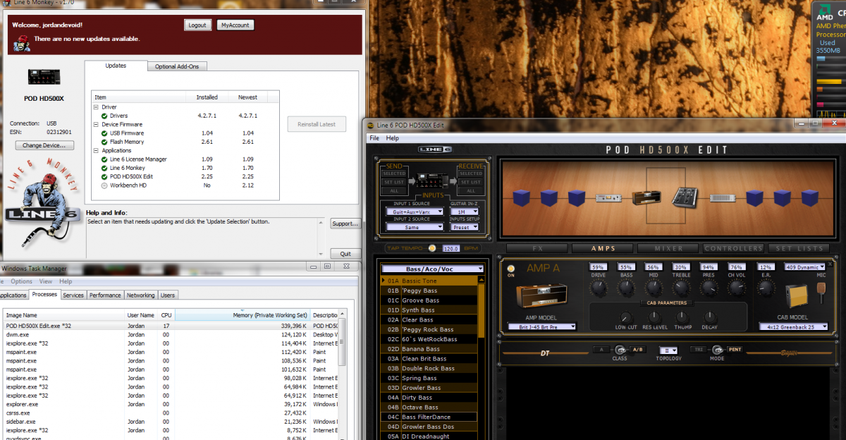

I bought the new model packs and upgraded all firmware and software, and since doing so, HD500X Edit keeps freezing up. Specifically, I can't seem to change AMP models. And I can see in task manager that the memory just keeps climbing into several hundred MB (and I assume it will continue to climb endlessly). Appears to be a memory leak. Anybody else having this issue after upgrading?
I've tried uninstalling and reinstalling. Screenshots attached.

Anybody else experiencing this bug, or can anyone with Flash 2.61 and Edit 2.25 in Windows 7 confirm that they aren't experiencing this issue?
Update: The program finally crashed when it hit a little less than 2GB of memory use.
I can confirm that I do not have this problem. I let edit run, with the pod connected to usb and turned on, for about an hour. The memory never went above 33MB.
It must something system unique, but unfortunately that doesn't narrow things down.
You said you disconnected USB. Does this mean you have the same problem when you run HD Edit in offline mode? And how quickly does this happen?

Just read your post after saying my system died at 1,919,976k - Nearly 2GB - with a HD500X (Latest new firmware).  Ofline it is stable at 28,784k - no movement for 5 mins. I switch on HD500X and don't touch anything - memory climbs - I haven't even said YES or NO to connecting to the device.  Even if I say NO and the SETLISTS are blank memory usage just keeps going up and up and up until Crash.
Well, at least now you can say it is something related to the pod physically being connected to your computer via usb, and only with the pod's usb firmware version of 1.04.
That would mean possibly an incompatibility has risen between your computer's usb implementation and the pod's (since usb 1.04). Could be either hardware, firmware (bios), or software (usb drivers) on the computer side of things, which you might be able to do something about. Try different usb ports for the easiest thing. You could look in your computer's bios to see what usb options are available.
If you want to rule out the pod and you have access to another computer, try the pod on that.
