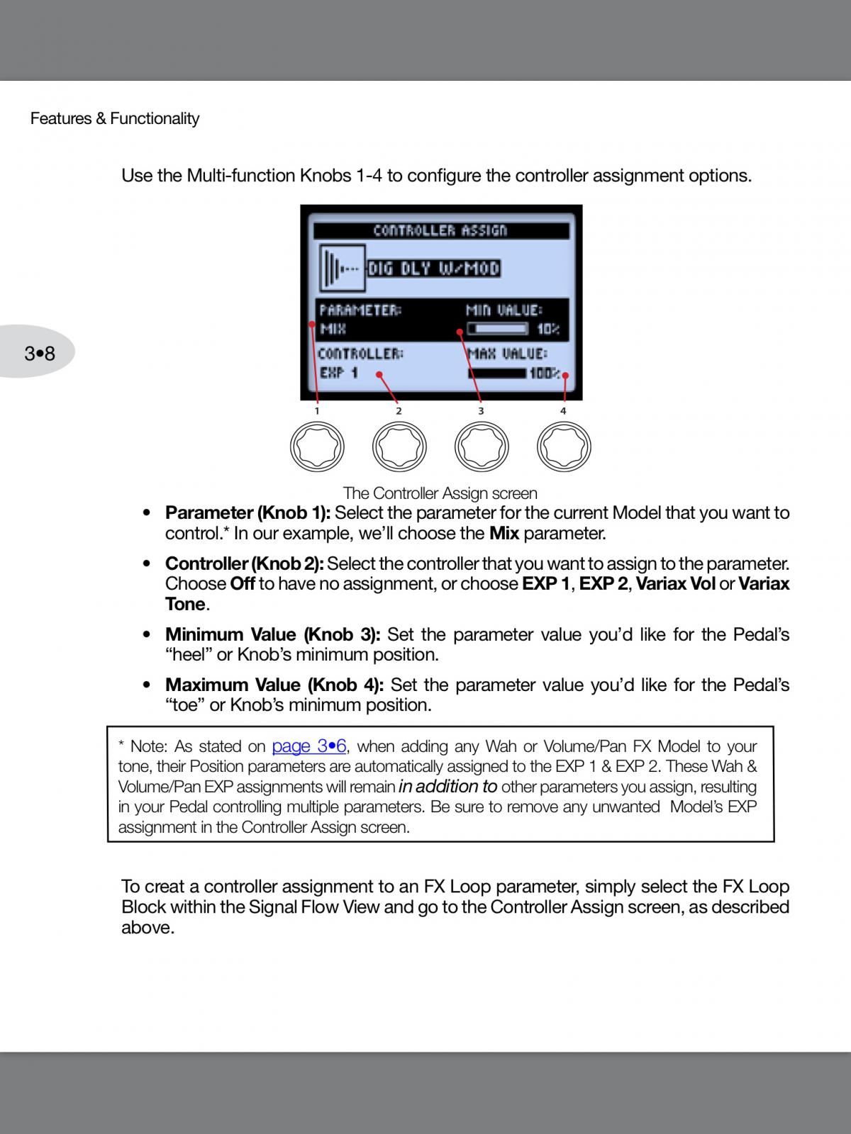

wilson69978 Posted May 10, 2015 Share Posted May 10, 2015 Here you go Alex. Have fun. Quote Link to comment Share on other sites More sharing options...
wilson69978 Posted May 10, 2015 Share Posted May 10, 2015 That's pretty neat.This could be really useful as I used to love self-oscilating analog delay pedals by playing with the time and decay knobs during a song or Jam. Maybe there's a way to do so on the 500x with any of the analog delays?Here you are Alex, hope this helps. You could use the on board expression pedal, and a second expression pedal, and assign time to one pedal, and decay to another. Quote Link to comment Share on other sites More sharing options...
