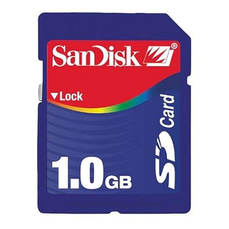

Why is there a 2GB limitation on the SD card?  Is it that the Spider Jam can not format SDHC cards?  FAT 16 format only? You can get 4GB SD cards that are not HC and effectively double the storage.  I see the 2GB storage limit as a major problem. I  had an older GPS that had a 2GB limit and was able to boost it to 4GB that way.  Will this work?  Has anybody tried it yet?
4GB non HC SD card link: http://www.newegg.co...N=-1&isNodeId=1
I suppose the Spider Jam's brains can only manage a small amount of storage is the reason for the limitation. I always just format the card in the amp. I'll record songs with the amp and save them as a Wav file to the SD Card and I can do quite a few songs before I have to upload to my computer.
Keep in mind you can record also by micing the cab or direct by using the headphones out. I've done both with ok results but as long as I can record using the Spider Jams memory I will.
I found a standard 2gb SD Card on Amazon >>>> http://www.amazon.co...d/dp/B000YH5FOK
and 1gb which I use >>>>> http://www.amazon.co...1WHCJA2AJYZ5YEB

Brazzy,   Thanks for responding.  I've been pretty much doing that the same way.   However, I like to have a good selection of favorite backing tracks on hand for quick playback (i.e.: live playing). Swapping out 2GB cards is a possibility and I find hooking up a separate MP3 player for this task a bit of a pain. And you have to redo your control settings per backing track every time. Like many older SD interfaces, I think the SD on the Spider Jam can't handle HC because of the FAT 16 formatting. I ordered a 4GB  non HC SD card and will test my premise and report back.  Nothing ventured, nothing gained !
