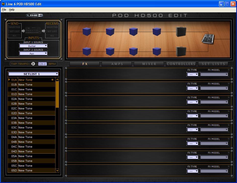

OK, simple scenario.
-Two acoustics; one plugged into 'guitar in'; one plugged into AUX in.
-Add two clean amps and BINGO: guitar 1 comes out of left speaker; guitar 2 come out of right speaker. Everything's OK.
What's the problem?
In this application I don't want any amp modelling, and when I disable the modeled amps, now guitar 1 is in both speakers and guitar two is in both speakers.
This is extremely frustrating and has been driving me crazy!
All i have is a little reverb at the end of the chain.
PLEASE can someone help me!

Sure, it can be done. You just have to create a dual tone with Path 1 and 2 completely separated and hard panned at the mixer block. I'd start off with something like this. Just don't put anything in the amp blocks.

Thanks. Tried you suggestion and it worked.
Thing is when i move the blank effects blocks back into the 'single' pre-amp tone path, I was still getting a panned output. I could no longer replicate the problem...
Hmmm
