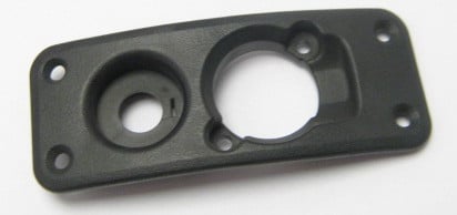

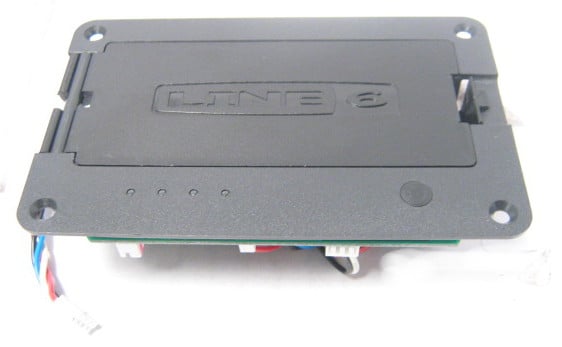

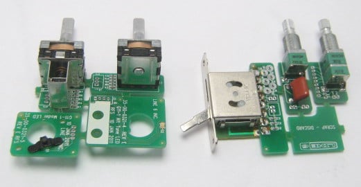

Order Spare Variax Parts here from FullCompass
http://www.fullcompa...der=Bestselling
http://www.fullcompa...uct/444501.html
http://www.fullcompa...uct/449095.html
http://www.fullcompa...uct/450983.html
http://www.fullcompa...uct/445858.html
http://www.fullcompa...uct/429493.html
http://www.fullcompa...uct/454355.html
