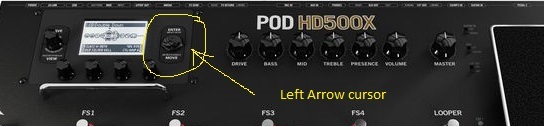

Thats a bummer.  I have only had this happen to me once and that was a few months ago.  What you need to do: "Power up the HD500x while holding the Left Arrow cursor down" and this will do a global reset.  Hope this helps.
Attached File  Left Arrow.jpg   26.91KB   1 downloads

Thanks silverhead,
Followed your instructions & - bingo - I brought it back to 'virgin state' life :)  ... yes, thankfully I had the backup of the patches from earlier tonight, reloaded fine, re-calibrated the pedal & created a latest backup  :)
