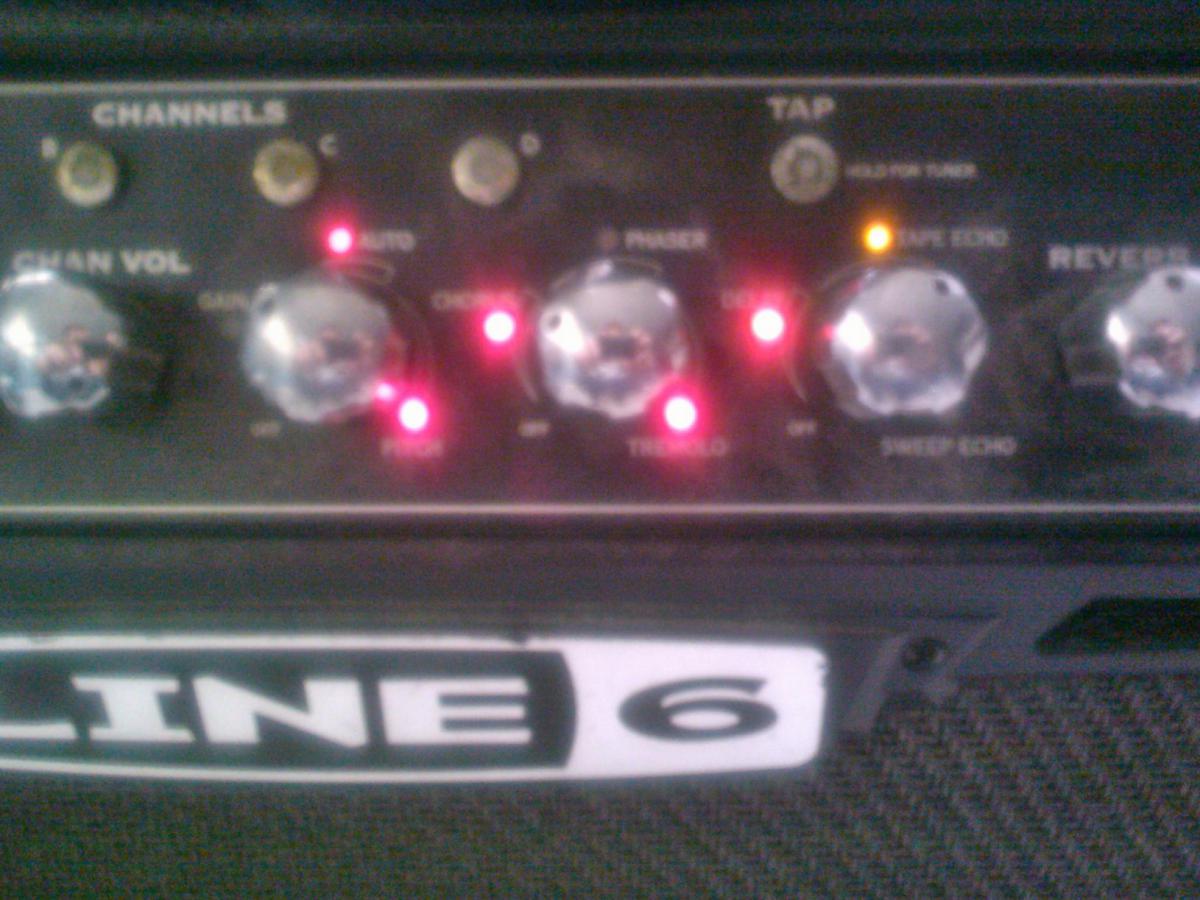

i have 2 problems with my amp effects, is a spider iv 75 w.
the 1st(i anexed a photo) is that now when i turned on the amp, all the effects "turned on" and i cant deselected,or turned off
the 2nd is that when i put any of the tones, for example clean green y doesnt put me the effects that it suppose to put automatically
sorry for my english, hope someone can help me!

No photo attached!
You could try a factory reset - hold the 'A' or 'Clean' button in while turning on the ppwer, and hold it in for 5-8 seconds.  Note that this will delete any user preset patches you have created and saved (in a model 75 or higher).

Heres the photo, i already do the reset but it doesnt fixed :(

You definitely should not be getting 2 effects activated at the same time on the same control.   You will need to bring yoru amp to a factory-authorized service center.
