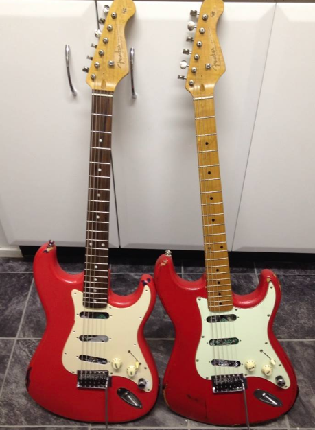

I used the lot - on my 1970 strat I used to be able to get away with using graphite on the nut (it had a brass nut, and it was pretty good), then the last refret it had the nut replaced with a graphtech one. No tuning problems!
I got the 600 as I was a trem user, and tried everything to remedy the problem to no avail. It doesn't matter so much about the nut (I replaced the nut with a graphtech Tusq-X or whatever - easy enough to do, just sand it down on the underside so it's the same height as the one you're replacing). The problem is the poor quality metal where the bridge pivots on it's two posts - mine had badly worn and no way was it ever gonna return to zero.
This gave me the next dilemma - replace the trem or transplant the guts into another body? I believe the original strat trem with six screws securing it to the body is far superior to the commonly found two post system for tuning stability, and this is supported by my resultant transplants (one from a 300, one from a 600) into a couple of cheap ($100 each from pawn shops) SX Vintage series strat copies, with the Graphtech Ghost saddles, and Tusq-X nut installed, giving me as close to perfect tuning as I've ever had, even with heavy trem use.
A bit of work there, but if you're handy with tools, it's totally do-able.
Now will the real Fiesta Red Strat please step forward?Attached File  Screen shot 2013-12-14 at 10.42.20 AM.png   286.58KB   1 downloads

Thanks for the info. I have a problem with the zero-point on my guitar too. I agree the 2 post thing is probably a cause for it, because I wouldn't be surprised when I push down the trem, the bridge gets dispositioned a bit causing it to go out of tune. I'm sure a mag-lok would fix that though.
It's annoying having to fix the guitar up when it should be at least decent to use.
I think a tusq nut and a mag-lok would fix it up though. I also might need fretwork because my action is a bit too high for my taste, and it buzzes if I try to push it any lower.
