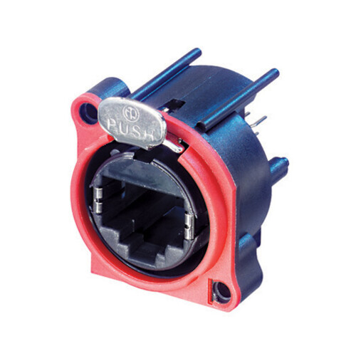

I know that this was discussed before but I can't seem to find a conclusion of how to replace the variax connector on the 300. I have one that works intermittently. Push the  cat 5 cable toward the narrow end and it works, toward the wide end and it doesn't. I am assuming that it is finally wearing out.  Can someone suggest the easiest way to replace  or maybe adjust this for  novice? I don't want to send it to a service center since I am in Hawaii. I was hoping for a simple DIY solution.

See if any of the pins look  bent or damaged.  You may be able to straighten a bent pin.  Common cause of damage on these is accidentally trying to plug the 1/4 inch plug into that jack.  It happened a lot on the old Variax's.  Everyone loses the rubber  plug that comes with it to cover the jack.  The JTV has a hinged cover - much safer.

If you are unable to fix the jack, a replacement part is available. The plastic piece that houses the 1/4" jack and the VDI jack can be removed and replaced. It's simple - a few screws outside and a plug-type connector inside. You will also need to remove the pickguard (another few screws) to access the plug connector inside.
Call Line 6 (see Contact Us at the foot of this page) and ask them to refer you to your nearest Line 6 parts supplier. They should be able to mail it to you.

The pins are inside the plug on the guitar.  They can get bent and not make good contact with the plug.

Note also if you replace the entire jackplate assembly, the new ones (I guess designed for the JTVs) are slightly longer and you'll need to attack the body of your 300 with a chisel and hammer in order to remove some timber allowing it to fit properly.

http://www.fullcompa...uct/431850.html
