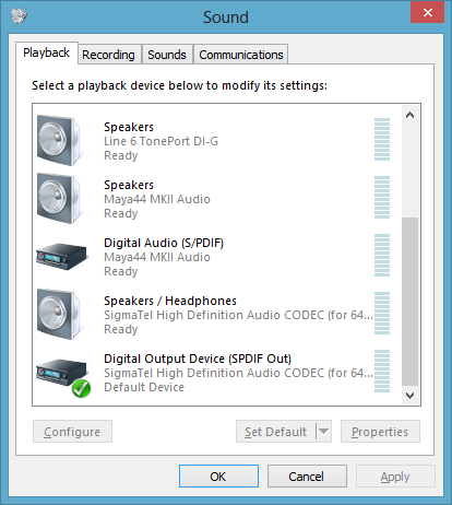

#16 TheRealZap
TheRealZap
    Uber Guru
  • Line 6 Expert
  • 17789 posts
  • LocationClemmons, NC USA
  • Registered Products:17
Posted 05 June 2013 - 08:23 AM
I think your drivers need uninstalled and reinstalled. the screenshot above only shows the digital out as available and as default.. so unless you have something hooked up to your SPDIF out you wouldn't hear anything.
