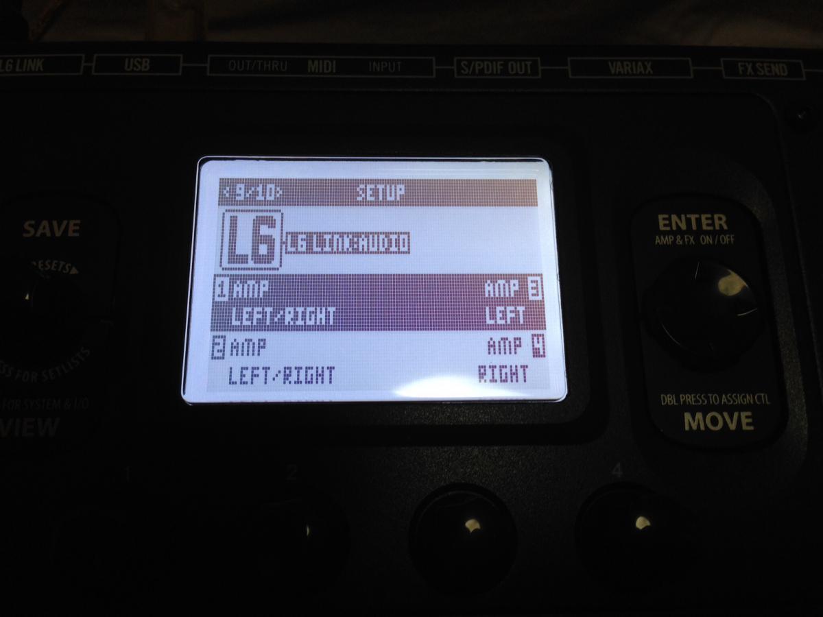

Hi guys have finally settled for a HD500X with a L2M speaker for my dream rig however there's no sound coming out of the speaker when during L6 connection via XLR cables. But it does work when I plug it in with a 1/4 inch jack from 500's output r/mono to the l2m's signal input. I have attached a picture if that would make it alittle more comprehendable.

EDIT: One other possibility. Check the L6 LINK Audio Setup on page 9 of the HD500X Setup pages. Make sure it is not set to Mute.
