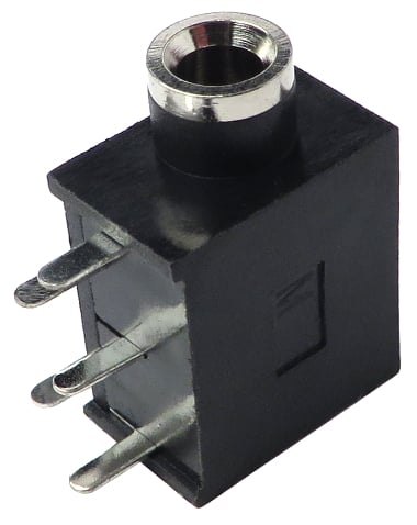

I'm trying to use the pod 2 through the Spider jam but bypassing the amp bit so I'm just using the speaker in the jam
The pod can sound pretty good if you just run the 1/4" L mono out into the Aux in on the SJ. I do this all the time but I've got the SJ's Aux in Tone stack/Reverb and Delay/ Compressor settings set to the way I like.
You could also use an insert cable like this. Insert Cable
Maybe you could clarify exactly what you want to do, I'm a bit confused.
Holy crap it does, Thanks man!!!! :D
Your welcome. It's the only one I could find that matched your description but I only searched for a few minutes. Hope it helps.
