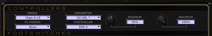

One option; try assigning the volume pedal to the amp(s) volume parameter.  And, yes, the volume pedal maintains your stereo signal.  To globally reduce volume while maintaining gain, it's probably better towards the end.  In front, the volume pedal can act as a preamp; and have more of a 'clean up' effect as the volume is lowered.
That is a great idea, assigning the expression pedal to the channel volume of the amp. Looks like that will also free up one of the 8 DSP FX channels. So, if I can't think of anything else I want in a patch, I use the EXP 2 Mission pedal for wah. I don't suppose wah would be stereo. Wait, let me look back through the HD500X Advanced Guide. I quote, "It is important to note that some Models (all EQs, Wahs & Volume, and some Modulations,
Filters, Pitches and Delays, as well as the FX Loop) preserve a stereo output within the signal chain, while others (all Dynamics, Distortions, all Amps & Preamps, and other various Models) are mono FX and do not." So I can put the wah on the end of the chain without worrying about loosing my stereo effect. Awesome. Where is the list that states if an effect has a mono or stereo output? Can you tell by looking someplace in the edit software? Maybe a block diagram of the HD500X would be helpful also. Thank you.
