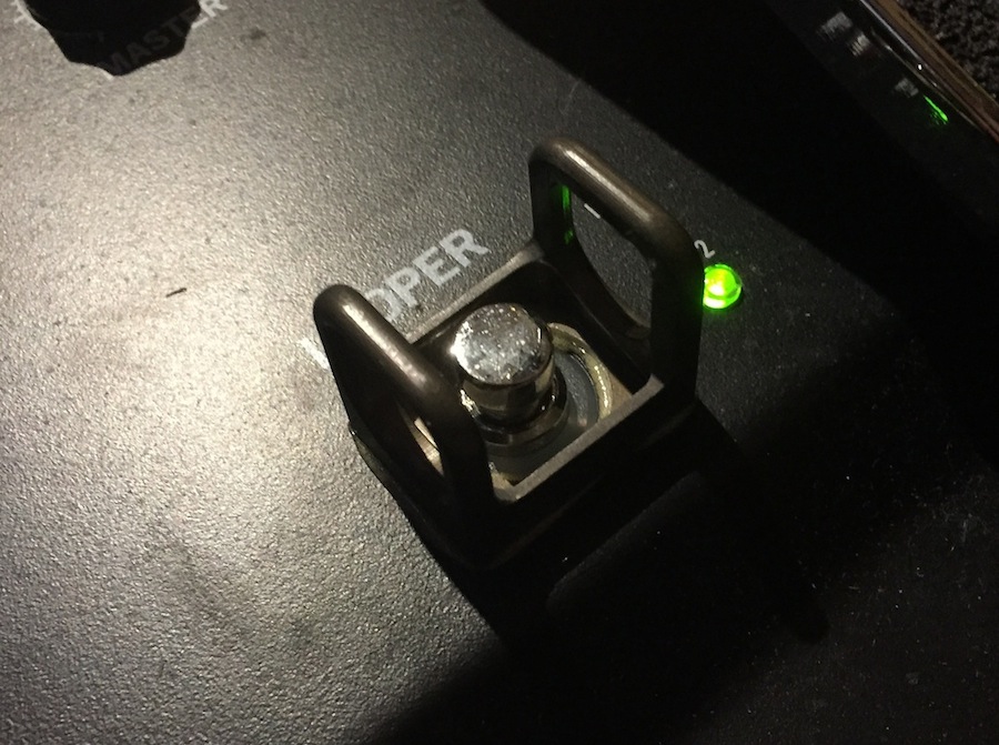

This was driving me crazy. They told me to stop wearing "clown shoes" and switch to something pointier. Here is the solution I came up with. These switch guards were designed for the space shuttle and are easy to find on eBay.
  • Upvote 2
That's a great solution. How have you fixed it to the POD?
I've heard of people putting a rubber band under the overhanging part of the switch, restricting depresses. Easily removable too.
a small amount of Gorilla glue that could easily be removed.
