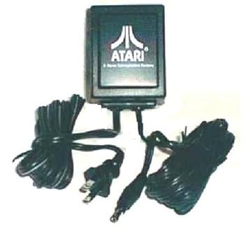

I am also looking for an alternative p/s for my HD500.  My problem is that the sideways wall wort does not fit in my pedalboard setup.  I have a perfect size suitcase to fit the HD500, a power strip, and my wireless receiver.  All I do at a club gig is open the case, plug in the power strip, plug in the L6Link to my DT25 amp and I'm done.  I wish Line6 would provide an option to the sideways wall wort power supply for the hd500, similar to this with a short a/c cable.  This would be perfect for my situation.
