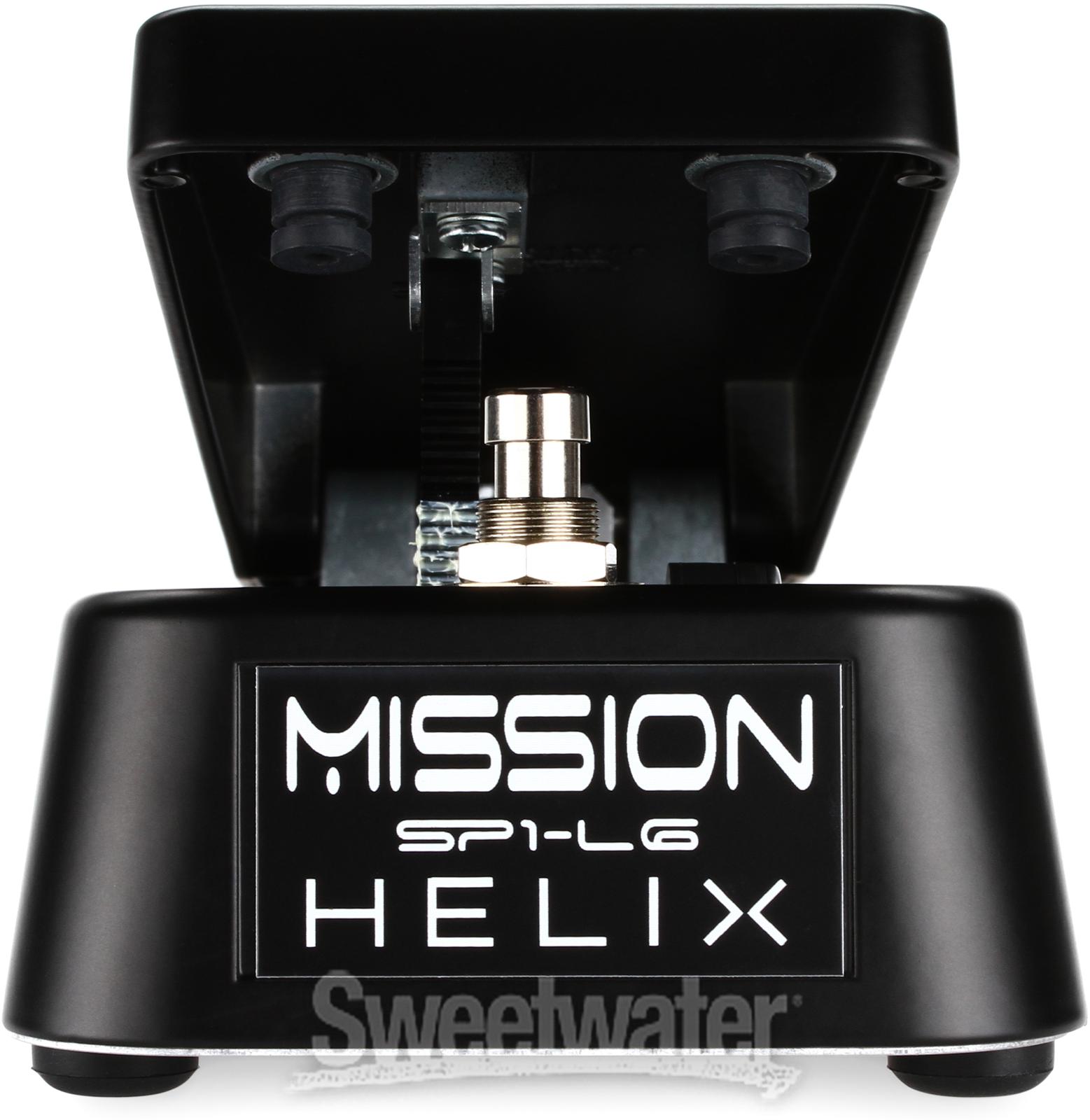

Word is Santa is bringing one of these down my chimney. And when I say Santa I mean wife, and chimney I mean FedEx. I'll report back after Xmas on how it works. I envision using this for all sorts of things, depending on the patch (delay feedback, univibe speeds, reverb mix, you name it).
I think it's specific to Helix Rack? Looks like the controller for Helix Rack has an input for "exp toe switch", and the rack also has that input- but the Helix floor unit does not.
  • Expression pedal for Line 6 Helix Rack (only)
  • Perfect for using Helix Rack live, making effects switching easier
  • Pedal range is optimized for Line 6 Helix Rack's expression pedal input
"It has a toe switch to engage/disengage your effect of choice for ease-of-use. Just connect the output of the SP1-L6H to your Helix Rack and assign the switches to the effects you want to toggle. "
AH....ok...gives me an idea
After the warranty is expired on the Floor Helix, somebody could parallel the wiring on the Helix internal toe switch and bring it out to an external 1/4" jack... hmmm
