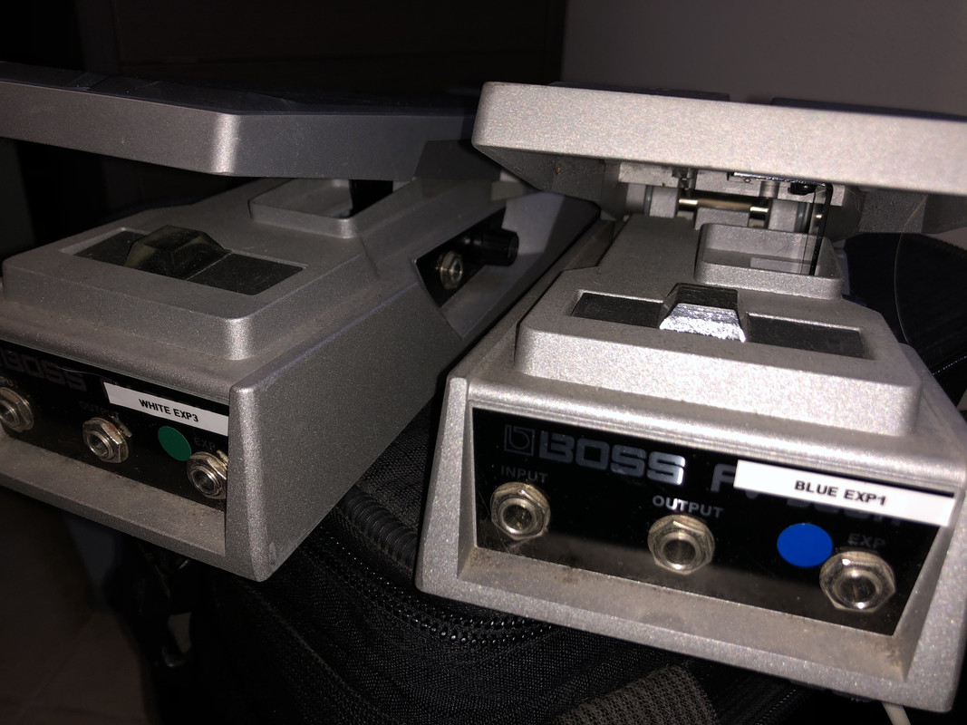

I've two FV-500H. They works (great for me, once you are used to it) but you need to know few things before to buy;
there are noticeable dead spots for both heel and toe
Total sweep is 18°. Heel Spot is 4°. Toe Spot is 4°. Real Sweep is 10°.
Helix pedal is Total Sweep 17°. Heel Spot is 1.5°. Toe Spot is 3°. Real Sweep is 12.5°.
After that you'd need to create a dedicated cable;
12993337_1799338483621044_71349833397048

Just figured out how to use my FV-500L with the Helix as expression:
- You will need one TS plug and one TRS plug.
- Solder hot and shield to the TS plug as usual (shield to sleeve and hot to tip)
- On the TRS plug, solder the shield to Tip and Ring; and hot to sleeve
- Connect the TRS end to the FV-500L expression socket, connect the TS end to EXP3 on the Helix. You should be good to go.

Hi - I finally cracked this last week too!  My wiring was very similar but not quite the same.
Other posts say you can't use the FV-500L/H pedals but they're wrong and this is such a great pedal.
I used a standard mono (TS to TS) lead but on the pedal end I replaced the plug for a stereo (TRS) plug.  The critical thing to remember is to ensure the RING connection is not connected.
Helix EXP o/p                                               FV-500L or H  Expression Pedal
mono (TS) jack                                             stereo (TRS) jack
TIP <-----------------------------------------------------> TIP
                                                                            RING (not connected)
SLEEVE <----------------------------------------------> SLEEVE
  • Like 2

I posted this elsewhere but thought I'd add it here too.
I have worked out how to use my BOSS FV-30H with Helix as an expression pedal. If you put a dummy jack in the input and a TS to TS in the output, Helix picks it up and autocalibrates with no dead spots. The Helix doesn't seem to mind it's got a 250K pot in it. I used a 3.5mm stereo headphone adapter I had spare as the dummy. Logarithmic response though, so as FranCollQc has pointed out, limited range at toe end. I ended up putting a spacer under the toe end to let the Helix see a more linear part of the resistance curve when it autocalibrates.
Hey!
Would you mind posting some pics/description of how you did this? I can imagine it's not a tough job to do, but I'd like to get some inspiration before I try to do it myself. It might be a helpful starting point for any other pedals that have a similar issue with the logarithmic response.
I had a look where the stops on the pedal contacted the base and put those sticky rubber bumpers/surface protectors on the base. It takes out that last 10 degrees or so. Pic attached. Different thicknesses will take out different levels of toe but reduce travel. Hope it helps you out.
Did the same with my FV500H. :)
