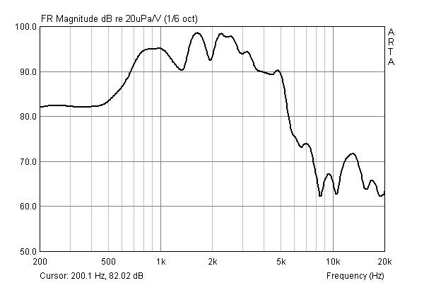

i made a quick and dirty measurement of the line6 celestion G12H90 from my DT25 Combo:
So there's a lot of midrange and just few bass and treble but both are needed für acoustic sounds more then für electric sounds. Other guitar speakers have a similar behaviour.
I found some pretty good acoustic sounds in the customtone database and they all base on the utilisation of lots of EQing to eliminate the guitar speakers character. And with a lot of WQing, there often come a lot of unwanted noise.
