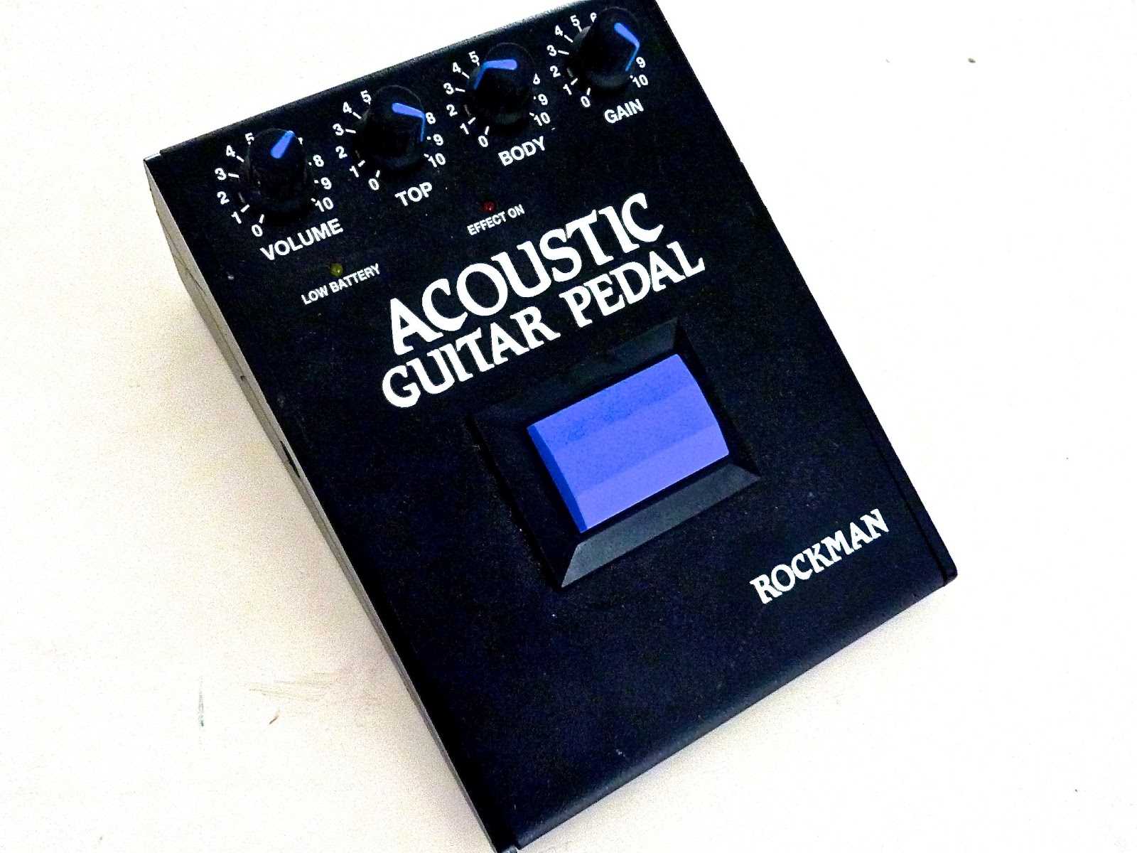

Piezo works best... unless of course you have one of these... and that's pretty much all you need.
