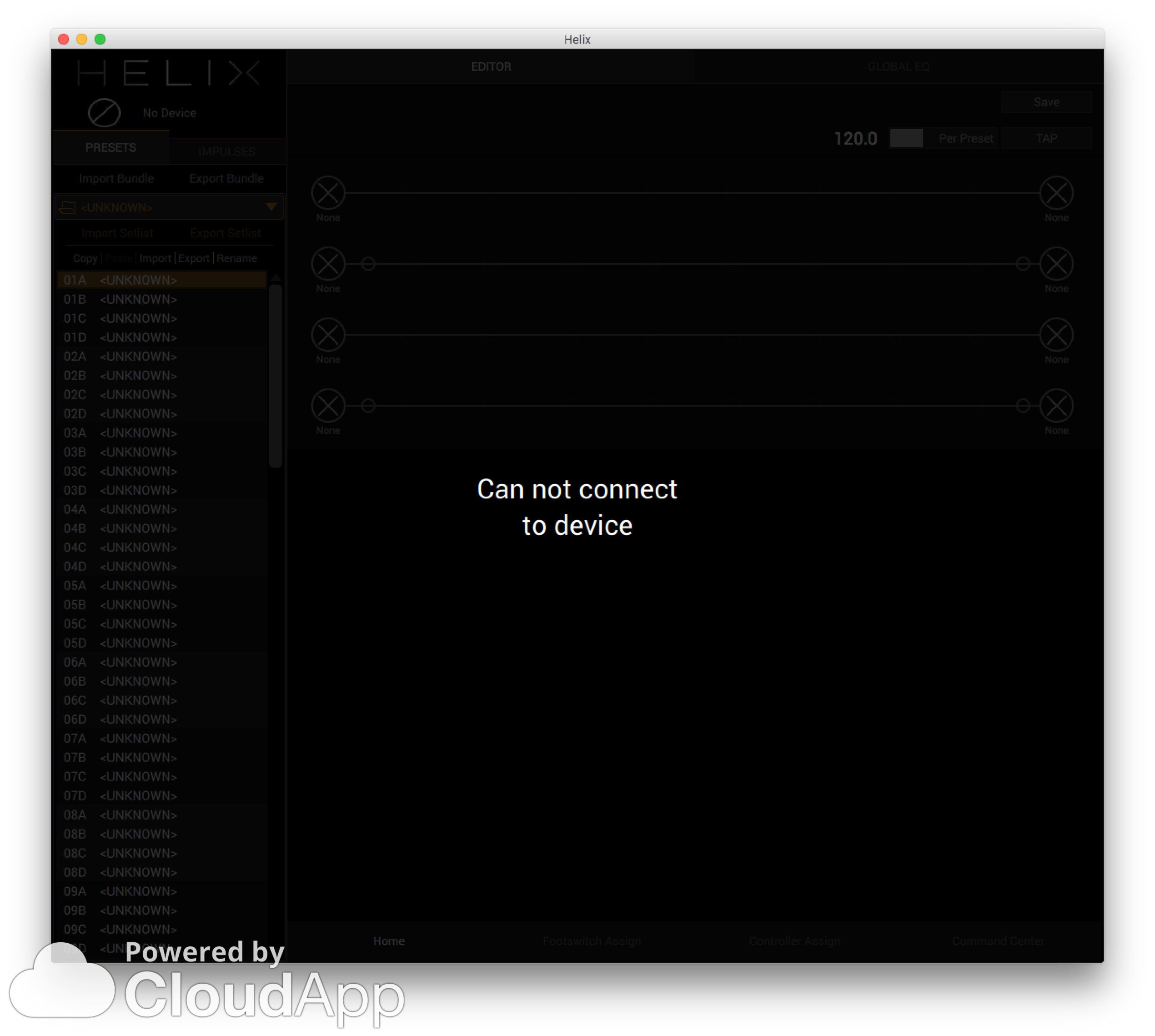

Editor "Can not connect to device"
Anyone on MacOS 10.11.4 experiencing this?
I know the Helix is connected and I know that the Mac sees it but the editor (almost always) shows this message.
I opened a ticked with Line6 Support but I figured I would check if anyone else is having this problem and have a workaround.

No. I posted an image of the error I'm talking about on the first post. Also you're running a Windows computer.

No, I posted the image when I created the topic. Maybe it didn't load for you? I suggest you open a ticket with Line6 Support to see if they can do something about your Windows issue.
