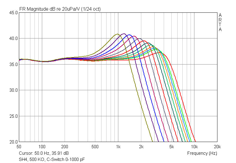

mikisb Posted April 10, 2016 Share Posted April 10, 2016 Hi zooey, Yes, all this is in my case inspired by Lemme, who sells C-switches, but i mady mine myself. To not to talk to much, i try it with pictures. This happens to a Pickup by changing the capacitive load before the first buffer (own measurement), this is a Seymour SH 4 with C-Switch 0-1000 pF and 500 KOhm load. you will notice that a short cable with 100 pf and a long cable with 1000 pF make a huge difference!!!!! This happens to a Pickup with different resistive loads (sum of tone + vol + Amp) The same SH4 with 106, 207 and 328 Ohms load at 569 pf kapacitive load. So if your buffer is behind two 250 Kohm pots, you have a resistive load of 125 Kohm and a capacitive load from about zero. I cannot know exactly what you're hearing and what of this you don't like. But perhaps these measurements help you to discover the reason and to find the solution ;) To say that the SH4 does not have a strong resonance, other pickups have far more (depending on the winding, magnet, construction of the Pickup. A strong resonance can sound very characteristic but it can also also kill your ears. So it's all about your taste and your gear you're using as with passive pickups, this often changes more than a new pickup. Unfortunally, a lot of people won't believe this - a lucky fact for Seymour, Di Marzio..... :D After all, it's not rocket science, so a lot of Voodo is needed to make money ;) Quote Link to comment Share on other sites More sharing options...

mikisb Posted April 10, 2016 Share Posted April 10, 2016 there's nothing else going on. But again: Where in the circuit of the guitar the buffer is positioned? Between Pickups and potentiometers or after the potentiometers? Or are you comparing different guitars with different pickups? Each pivkup has its individual resonance frequency and "peak strength" and is influenced individually by pots and cables. This all depends on the inductivity and resistance of the pickup coils, how they are solded together and some other details as magnets, magnet position and magnetic materia (as steel) in the coil. Sorry that i'm perhaps a little bit slow in understaning, but a foreign language makes things not easier to me ;) It would be easy if you could pass by and we could measure your guitar and cable, but from Boston to Germany is not this easy. Quote Link to comment Share on other sites More sharing options...
