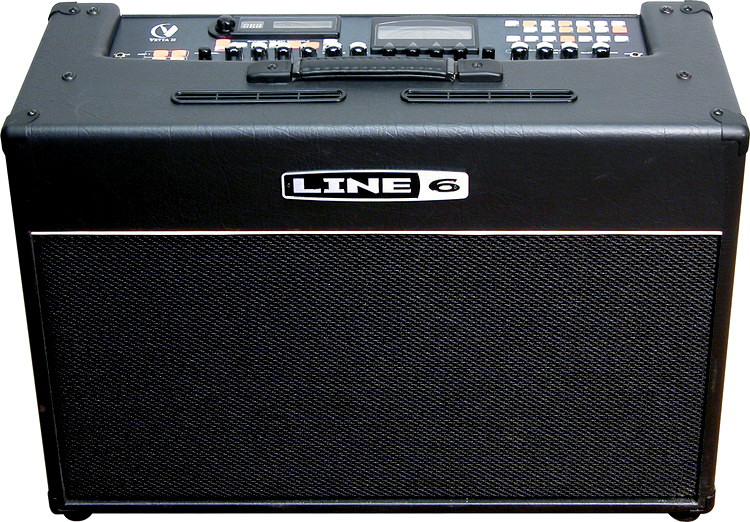

Dang, that Vetta II combo is still a sexy looking amp.  I looked at the back and it has stereo inputs that should work well for Helix.
It looks like the Vetta is using a version of Celestion Classic Lead 80's, which will have some guitar speaker/cab character of their own. If/when you go to test them together, try the Helix full amps with no cabs/IR's.   Try them with the cabs too.
With Helix, a solid state amp and traditional guitar cab with Mesa Black Shadow C90's (custom Celestion Classic Lead 80's), I was finding Helix amp models with cab/IR blocks too dark and without cab/IR blocks too bright. But...
...I tried a cool trick by putting in a cab/IR block, but splitting the path to have a side-chain parallel path with a cab around in/out of the thru path.  This passes a bit of the amp-only signal too.  You can adjust the cab/no-cab path mix on the split.  This will give a bit of both worlds and really sweeten things up.
But as stated above and many times in other threads, the Alto's and L6 Stagesource speakers are great, straightforward FRFR solutions.  I'm just throwing this out if you are feeling experimental and cheap  ;)
P.S.  I own a DT50 too and actually prefer Helix full amp models>solid state amp>guitar cab over Helix preamps>DT50>guitar cab.
...I tried a cool trick by putting in a cab/IR block, but splitting the path to have a parallel path with no cab around the cab/IR block.  This passes a bit of the amp-only signal too.  You can adjust the cab/no-cab path mix on the split.  This will give a bit of both worlds and really sweeten things up.

I messed with it a bit more today.  Having the cab/IR in the side path rather than the thru path worked better functionally for me. The Mesa C90 alone is great for clean and bluesy stuff.  For mid to high gain sounds, I found about 75% path A thru signal and 25% cab signal takes some of the harshness out of the Mesa C90, with a touch of greenback cab model on the plexi stuff and a touch of V30 cab model on the recto/uber stuff was nice.  It wasnt nearly as dark as running full cab model signal through the guitar speaker.
I feel like this setup is a bit more versatile than going through real V30's, which you cant brighten for cleans.   It was good times though.
