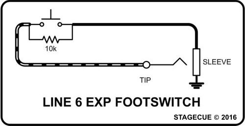

If you do want a switch then 10k ohm is one end of the range and shorted out 0 ohm is the the other.  Helix can handle the inversion if needed, but you can't see the state of most switches unless you have the parameter that it is controlling visible by being the currently selected effect.
The FS-5L is an exception because it does tell you the state - through an LED and battery on board which gets around this problem, but you still need a customised cable to make it work:
The FS-5L has two positions Open which is infinity ohms and Closed which is zero ohms.  If you take a simple 1/4 Jack cable where you can open the Jack up to get to the the wiring (or make one yourself), and solder a 10k ohm resistor between the Tip and Sleeve tabs of one of the Jacks, then it will give 10k ohms to Helix when the switch is Open and 0 ohms when it is closed which is exactly what Helix wants.

A simple SPDT push-on push-of switch will work.
You can even plug in a (normally open) keyboard sustain pedal and it will work as a non-latching momentary switch.
The 10k resistor is unneccesary
Howdy Folks,
You can use a footswitch plugged into an EXP Jack to go from full on to full off with a a latching switch (or stutter FX if the footswitch is momentary...  Just solder a 10K ohm resistor across the switch terminals...

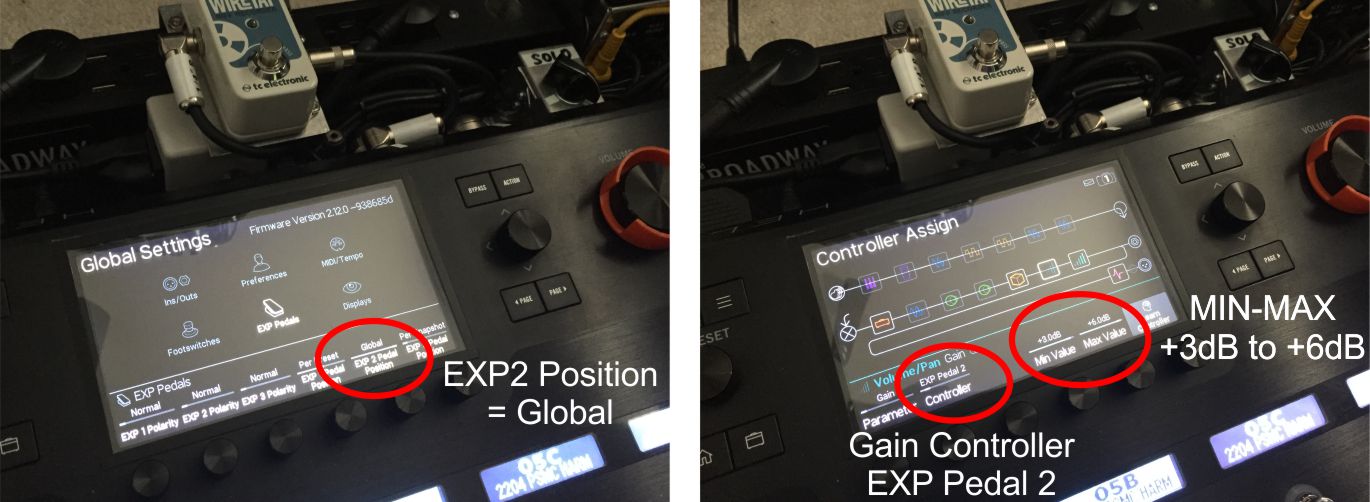

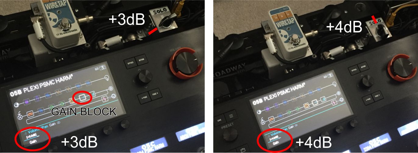

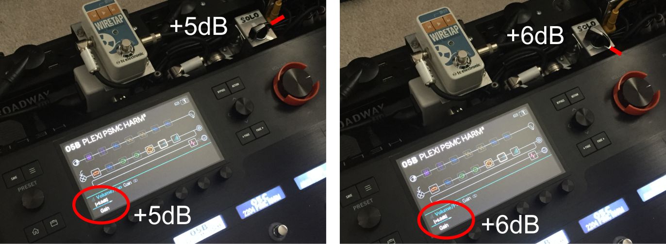

It is a small box with a pot and 1/4" jack connected to the HELIX EXP2
I set The EXP2 Position to GLOBAL and set EXP2 to control the GAIN of a Volume Block (MIN to MAX = +3 to +6dB)
I marked +3, +4, +5, and +6dB positions on the box, but it is infinitely adjustable.
Since EXP2 is set to Global, the Lead Volume that is set transfers to all Presets and Snapshots...
Just in case you need that little extra boost... available at the turn of a dial clear.png
