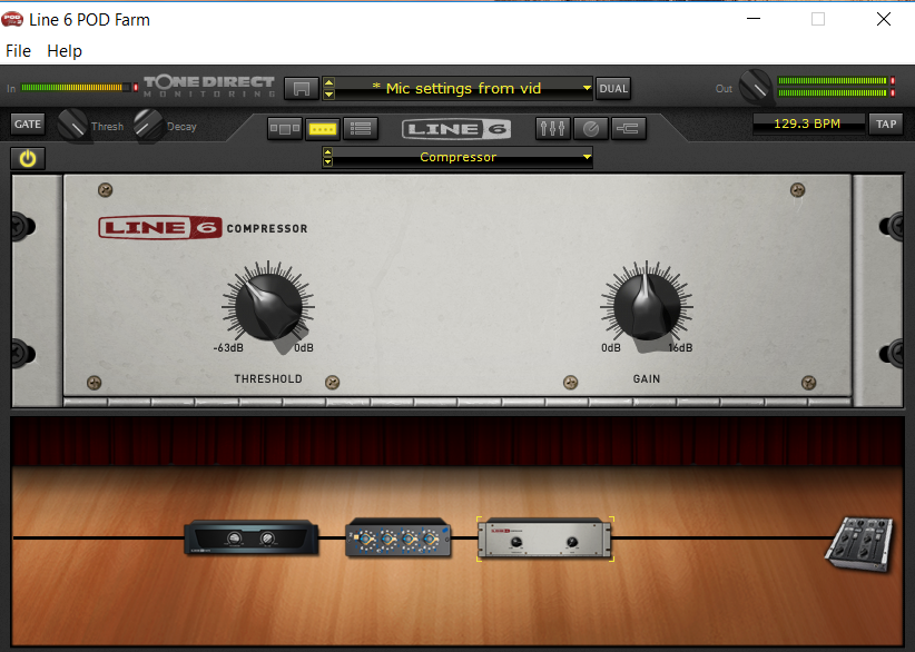

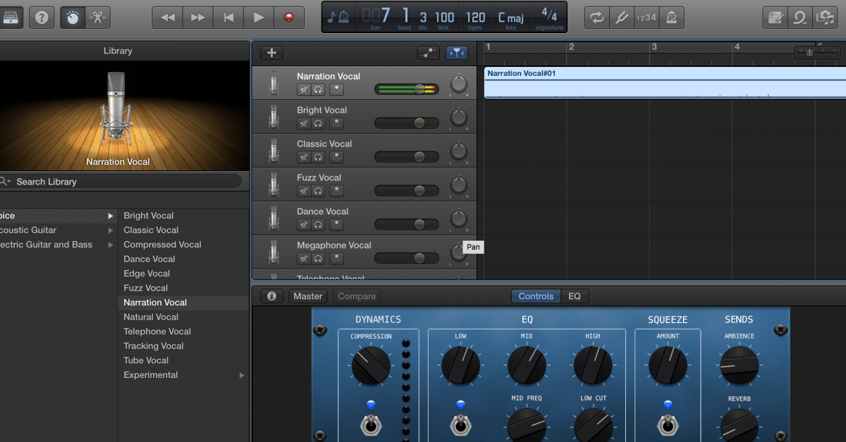

So I've just bought a Pod studio UX2 and an audio technica AT2035, both of which were second hand. Problem is I connect everything up (with all drivers installed) and as you can see by the photos the front indicators on the UX2 are maxed out but all you can hear is like white noise and clicking during any recordings. All my settings are included in photos, I am basically using the exact same settings as a YouTube video I have seen. Oh and if I pull the microphone XLR out then the UX2 still shows there being some kind of input.

In Garageband are you selecting the UX2 as your input/output device?
If so, try recording something even if you do not hear it, then change the input/output to the Mac's sound card and play it back to see if you are capturing a signal.

At the moment I'm just trying to get something recorded then listening to the recordings by playing them back, I am not trying to use my pc speakers as monitors, I can't record anything at all yet. I recorded then exported from garage band and all I had on the recording was white noise And you can see my settings for garage band . Also my room is completely silent. Thanks for the advice about audacity, I didn't know that
If you need any more screenshots let me know
I just noticed your Hard Gate Threshold (upper left in POD Farm)  is maxed, try turning it all the way down.
Also try turning the drive up in the American Classic model.
I can't, I only have the UX2 interface and no amps or anything, thing is though I plugged a dynamic mic into the xlr port on the UX2 and I cant get that to work either (with phantom power off) however if I plug it into the instrument port it works

There is no real wavefile as you can see by the first photo, just had a breakthrough of sorts though: before there was no audio just high pitched buzzing when recording, however I decided to see what would happen if I turned off podfarm and recorded directly in garage band, I found that there was still crackling and high pitched buzzing but I could hear what I had said and got some waveforms to show up! Im hoping that this means it is not a hardware issue, I've been very concerned that my UX2 or AT2035 were broken.
