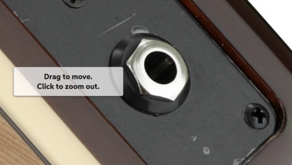

I'm having the problem with the Godin and the G10s as well.  I believe it is because the bolt that holds the 1/4" jack in the guitar has a  rounded, rather than flat, head (see attached photo) .  Therefore, the tiny mute switch on the g10 transmitter does not get depressed when it's inserted into the guitar.  I'd love to have a solution to this.  Right now, the only thing I can think of is to replace the bolt on the Godin.  Bummer...
Anybody found an explanation or a work-around?
Thanks,
Tom
