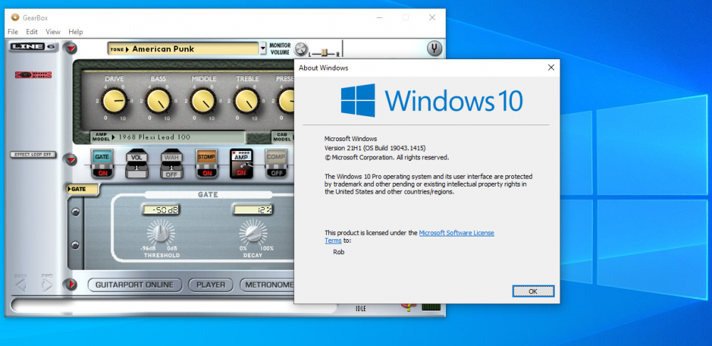

I'm literally editing my PODxt Live patches right now in Gearbox under Windows 10 21H1 (and also works on my laptop running 21H2), and can also connect my original Guitar Port in Gearbox 3.7.2 and have it recognized as an audio input for my DAW.

On 12/27/2021 at 8:18 AM, someguynamedrob said:
I'm literally editing my PODxt Live patches right now in Gearbox under Windows 10 21H1...
Nice that you can toot your own horn, but I'll bet other users would be interested if you could make a comment or two about your experience in achieving this. Did you have to jump through any hoops to get all the pieces in place, hold your tongue 'just right' in the corner of your mouth, etc?
As it is, your post comes off as "Nyah, nyah, look at me"...
