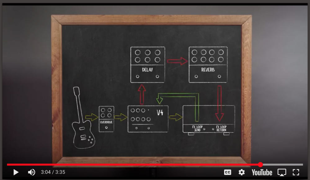

Got a bit of a technical question here with connections.  I bought the HX Stomp and I'm also interested in a preamp pedal. Essentially building a board for an amp-less setup.  Having a preamp pedal on the board and using the HX cab sims or IRs.
My question is connecting the two and output to FOH or powered speakers.  I want to run the HX Stomp in 4CM too, which is where the confusion lies.
Is it possible to even connect the HX Stomp and a preamp pedal in 4CM without using a cab? I've attached screenshots with the preamp connections.
EDIT: Maybe I was thinking too much into this, but would this be the proper connection?
  • Guitar > HX Stomp L Mono In
  • HX Stomp Send > V4 Preamp In
  • HX Stomp Return > V4 Preamp Effect Out
  • HX Stomp Outputs to FOH
  • In HX blocks, route the V4 Preamp before mod/delay/reverb
Thanks!

yes, This would the correct way. Or at least that is what I would do. Essentially hook up the V4 like it is a preamp of a regular amp

Actually, this scenario is described in the Victory Preamps Manuals in Q/A section:
I've try that with Kraken pre-amp + duchess V140 and Line 6 HX FX and it works like a charm...!!!
Q: I have a multi-effects pedal (a Line6 Helix for example) which I use with four cables method.
How can I integrate my V4 preamp into this setup in Amp-Through mode?
A: Connect the send of the multi-effects (which goes to the input of your amp) to the input of the V4 Preamp. Connect the Through output of the V4 Preamp to the input of the amp.
Then connect the amp’s FX Send, which goes to the return of the multi-effects’ return, to the Loop In of the V4 Preamp. Finally connect the Loop Out of the V4 Preamp to the return of the multi-effects.
This way both the preamp of the amp and the V4 are in the loop of the multi-effects and the V4 works in Amp-Through mode. If your multi-effects pedal has a short-to-sleeve type switch output you can use it to switch the V4 Preamp’s bypass and channels via the Remote Switch
socket.
