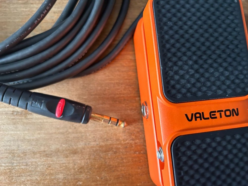

I'm trying to use a Valeton Surge EP-2 with my new Stomp.  The Stomp recognizes it, and  responds to it.  But, weirdly, instead of climbing from, say, 0-100, it climbs from 0-100 in about half the throw of the  Surge, then dives from 100-0 in the second  half of the throw.  I've tried three different cables:

All configurations operate the same.  Using the Y cable, it makes no difference if the Surge is on the TS or RS leg.  I've gone into global settings on the Stomp and inverted the ring, with no discernible difference.

exactly the same situation here. Using Valeton EP 2 to my HX Effects and it goes 0-100-0 from heel to toe motion....following this thread.
Sorry to say I never got it to work.  I ended up getting a DOD mini expression pedal, which works fine.  I gave the  Valeton to my duo mate, who uses it as an analog volume pedal for her guitar and looper.  I suspect I could have rewired the Valeton to work with my HX Stomp, but it wasn't worth the effort.  I also  suspect the weirdness is peculiar to Line6 somehow, not to the general run of effects pedal products, but I can't prove that.
L6 requires a very specific wiring for an expression pedal... not all pedals will work with it. Unless you buy something that is stated to work with a L6 product, you will likely need to mod it in order to get it to work.
My research (conducted AFTER I had purchased the Valeton pedal) suggests you are correct.  As I said, I think  I could have rewired that pedal, but it works great for my duo mate, and the DOD seems to work fine with the  Stomp.  So, I never really explored the rewiring scenario.
