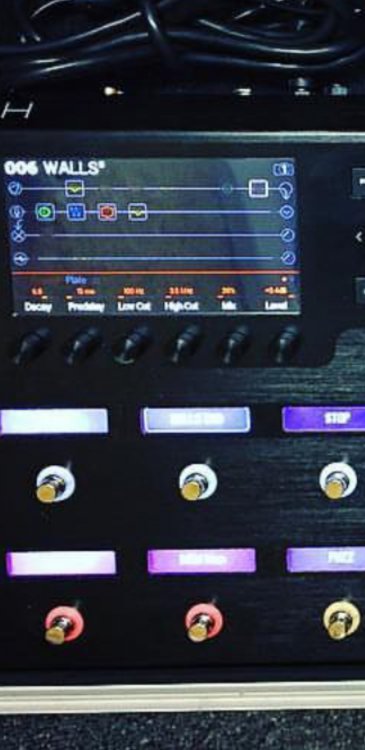

4 path routing - this photo confuses me
I was researching helix routing. Just got mine last weekend. I stumbled upon this on Instagram.
Could someone explain this patching/path to me on detail? Guitar into vocals in seriel into...?
Anyways I would be greatly appreciative of any discussion of what this style of routing is accomplishing. Thanks.
Looks to me like the one input (1A) is set to guitar input and then runs through an EQ and then some other blocks, at the end of the path 1A it is routed down to path 2A and then to an output.
Path 1B is set to be from the xlr input, run through some effects and then directly to an output at the end of path 1B.
