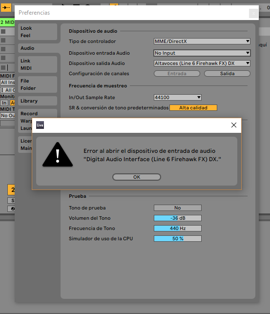

Hello! I'm trying to use my Line 6 Firehawk FX as an audio interface, but all the recording software are sending me an error. They say me "error to open the I/O dispositive".
I have the latest driver's and version's update.
My question is, I need to do an extra PC configuration? or what is the solution to this problem?
In the first pulldown menu on that screen, you'd want to choose ASIO as the driver type, not MME/Direct X.
