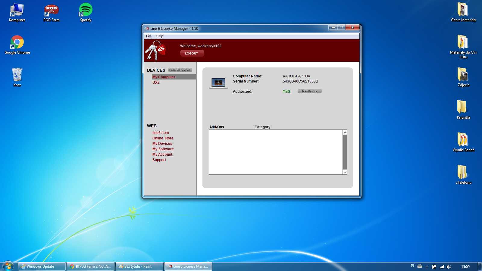

wedkarzyk123 Posted April 1, 2019 Share Posted April 1, 2019 Hi! I'm Karol and I'm from Poland, so I sorry for my language mistakes. I have problem with my Line 6 UX2. When I starting Pod Farm 2, he hasn't all amps and effects, and he showing me this statement (in attachment). How to fix it? Quote Link to comment Share on other sites More sharing options...
silverhead Posted April 2, 2019 Share Posted April 2, 2019 Have you run the Line 6 License Manager program? Quote Link to comment Share on other sites More sharing options...
wedkarzyk123 Posted April 2, 2019 Author Share Posted April 2, 2019 Yes. Pod Farm works correctly, but Pod Farm 2 no. Quote Link to comment Share on other sites More sharing options...
silverhead Posted April 2, 2019 Share Posted April 2, 2019 How old is your UX2? Older models came with a license for Pod Farm 1 (which I see you have). If your UX2 was originally licensed for Pod Farm 1 you may now have to purchase a license for Pod Farm 2.5. I would contact Line 6 Support to inquire. Quote Link to comment Share on other sites More sharing options...

wedkarzyk123 Posted April 7, 2019 Author Share Posted April 7, 2019 I have POD Studio UX2 (black faced). I don't know how old has this Line 6, because I bought it used from my friend Quote Link to comment Share on other sites More sharing options...
