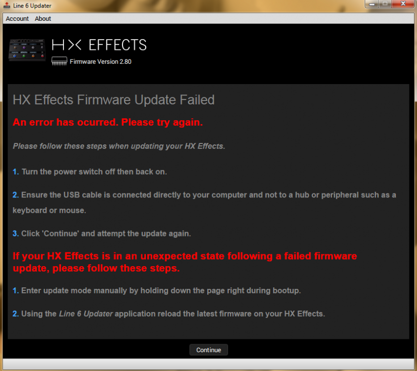

2.80.1 hotfix not installing
DimSam
Make sure nothing is connected to your HXFX other than the USB. Make sure that you downloaded the HX Edit 2.80 version and installed everything when you ran it and did not just update the firmware. Then I would try the USB and restart shuffle. Try different USB ports, maybe swap out USB cable, and restart both the HXFX and your computer. Rerun the latest 2.80.1 firmware update following Line6's instructions including their "failed firmware update" procedure displayed on the screenshot above if necessary.
  • Thanks 1
Already done all of that.The problem lies with the fact that although upgrading to 2.80 was flawless,now the screens are blank so when I hold down the > button and boot it,nothing happens.Blank screens.
Have you tried some of the global reset options to get things started again? Maybe someone else will chime in with a fix., if not it might be time to open a ticket/call with Line6 and have them walk you through a resolution.  I'm sure they can get you up and running again.
