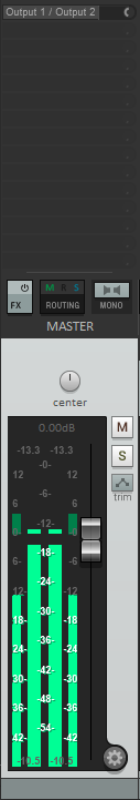

7 hours ago, FuZz3 said:
Well, im used to use a BOSS ME-50 straight to computer and in spite of not being made to record like this it record decent...Helix is made to record straight from the pedalboard... this volume is very low... the master will not help if the volume is low from the start. If this was the case i should get the same volume as you...
This is the master fader from my DAW (Reaper) using your patch.  As you can see, it is peaking around -13.  Compare this to your DAW's master fader and see what it is.
