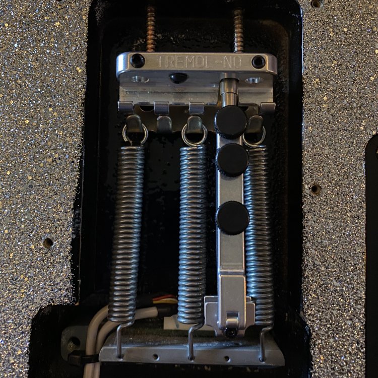

My other post has me thinking that I really want to install a Tremol-No in my JTV-69 but as mentioned in the other post, the JTV trem spring screws are closer together so I would have to fill them and re-drill for the Tremol-No. I've done this for a strap button before using toothpicks and woodglue but I have a few concerns here:
1. I don't know how I would get a drill in there deep enough at the right angle to drill new holes.
2. How would I make sure to position the holes exactly right? Just try and make sure the new screws looked equidistant to the old filled in holes?
I feel like this shouldn't be that hard and I really want to do it but also want to make sure I don't mess it up or that it's not far more complex than I think.

Yes the screws on the claw that the springs attach to. They are Spaced narrower than standard. I discovered that when I went to install my Tremol-No when I first got my JTV-69.

Here's a pic of the Tremol-No laying on top of my JTV trem.The black allen screws are directly over the claw screw holes. You can see the JTV claw screws are closer together. The Tremol-No is the standard claw screw spacing I've had on every other guitar I've ever owned. That's the stock claw that came with my JTV-69 when I got it brand new as soon as they were released.
