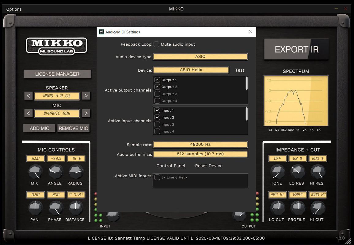

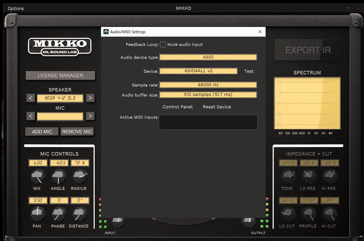

What I posted is windows 10 fyi - install asio4all you will get it working
It is standalone thats why I like it so much - be careful if you buy it and format your pc or upgrade OS you will have to request another license code real pia - Mikko does not get right back to you but as a standalone its great while running helix its real time in background
No latency using asio4all
Just be aware that Line 6 does not support ASIO4ALL. It is not a fully compliant ASIO driver and has been known to cause problems with Line 6 devices. If you encounter any issues Line 6 Support will, rightly, tell you to use th Line 6 ASIO driver and call back if problems persist.

Have it working with line6 drivers now - guess just messing with it rebooting etc. helps - not sure but I will stick with line6 driver
