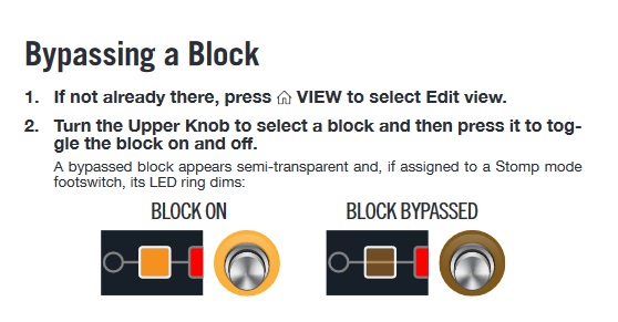

Well, the color of the block in the little signal flow on the top part of the screen does change in Play View. It's small enough, though, that it's probably not all that helpful.
Yeah, but as I said, I don't want to use a whole block for boosting. I just want to use it to increase the level of the output block. Could I change the color of the output block?
