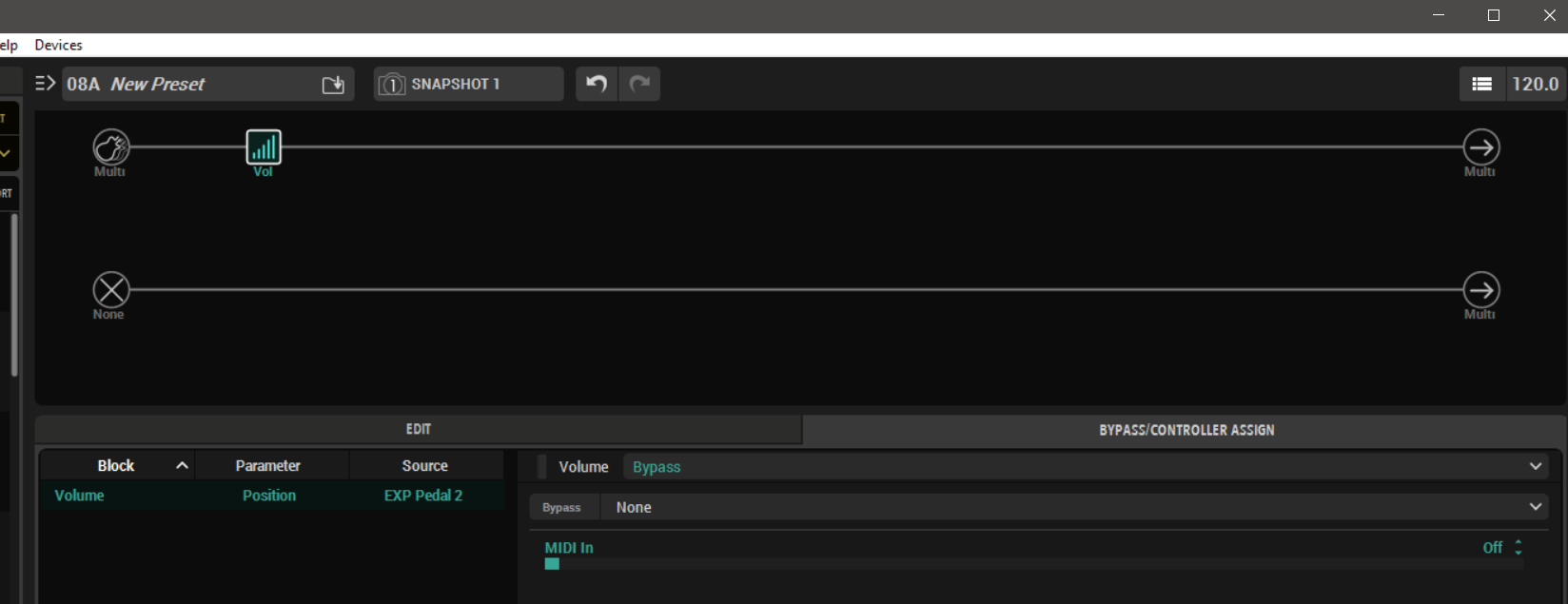

I don't have an HX Effects but here is my experience on the Helix LT:  I have my Ernie Ball volume pedal hooked up as Exp 2.  I added a mono volume pedal block to an empty patch.  Here is the configuration that is applied by default:
Note the "Bypass" parameter is applied to the Exp pedal toe switch.  That is the on-board volume pedal, and the toe switch will toggle the block on or off.  In your case, since you just want the external expression pedal to control the sweep, change Exp Pedal Toe to "none", like so:
 With that configuration, the volume block will always be active, and the selected expression pedal will change the sweep.  I hope this helps!
