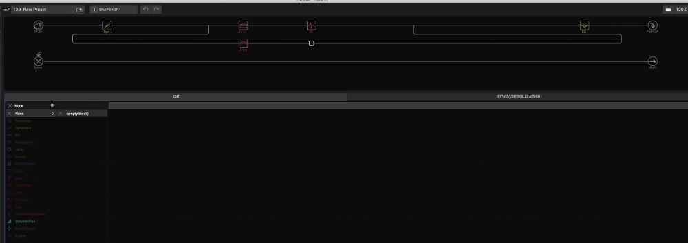

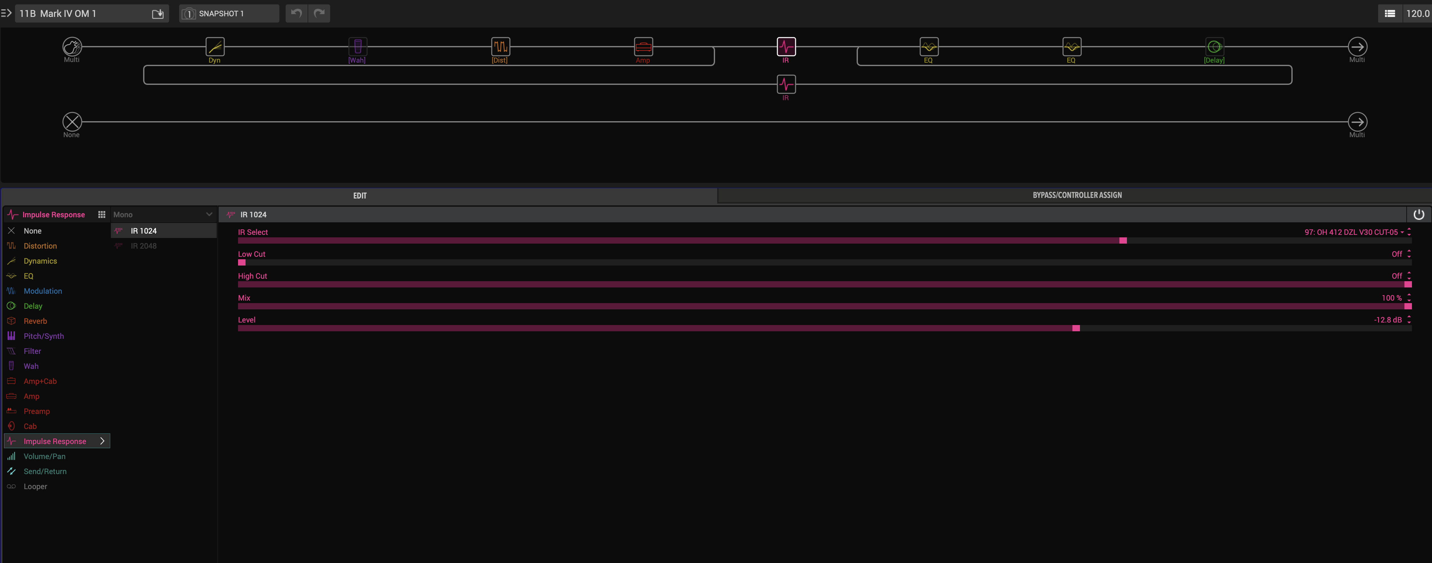

MesaSean Posted April 14, 2020 Share Posted April 14, 2020 Hey folks, new Helix user here and loving it. I am trying to run two amps and two cab impulses from Ownhammer (I bought the heavy hitter pack and really liking it. I also have the ML Sounds Labs Mega pack as well) I am trying to run two amps and blend them. One is a Mark IV and the other is the Soldano lead. For some reason it won't let me add the second cab impulse. I add the two amps and one impulse no problem. When I go to add two separate cabs, everything is gray and it won't let me add anything. Please see the picture attached... I have had this happen a few times. I think I am setting the paths up correctly. Is there something I need to set at the splits? Or do I have to blend the amps with ONE impulse some how? I have no issues running ONE amp and two cab impulses (see other picture) but when I make the split for two amps, it won't let me do it. Any advice? Thanks so much in advance! Quote Link to comment Share on other sites More sharing options...
rd2rk Posted April 14, 2020 Share Posted April 14, 2020 You're out of DSP. Try pulling that EQ out of Path 1 and moving it to Path 2. If that doesn't get it then you may need to swap out amps until you find one that works. Quote Link to comment Share on other sites More sharing options...
phil_m Posted April 14, 2020 Share Posted April 14, 2020 As stated above, you're only using one of the two processors. Paths 1A and 1B are served by one processor, and Paths 2A and 2B are served by another. You could do this a few ways, the most straightforward would be to have the output of Path 1A go to Path 2A and the output of Path 1B go to Path 2B. Then you can merge those two paths together. You could put both amp blocks on Path 1A and 1B respectively and then put the two IRs in 2A and 2B respectively. Quote Link to comment Share on other sites More sharing options...
MesaSean Posted April 14, 2020 Author Share Posted April 14, 2020 Thanks rd2rk. I figured it out but now have a new issue. So stupid me forgot that we you select and IR, there are two selections. IR 1024 and IR 2048. I don't know what either of those mean, but if you choose one, it only allows you to choose one IR to drop in. Now my new issue is when I go to put an E or other things... it won't let me (see picture) Guess that is a DSP issue? Wow that top path runs out of DSP quick eh? or am I doing something wrong. I wanted a parametric E but it is blocked out. Only other E's are available. Quote Link to comment Share on other sites More sharing options...
prudenjim Posted April 14, 2020 Share Posted April 14, 2020 You have run out of DSP. The Helix has two DSP, one for the top half and one for the bottom. On your screenshot it is like looking along from the ‘Multi’ circle and one from the ‘None’ circle. The bottom path is empty so that DSP is not being leveraged. Many time this won’t get in the way but with two amps plus two IR and other blocks you have maxed one out. One idea is to move an amp and IR to the bottom path. The top path output will continue to read Multi. it you will need to split off a line to feed the bottom path. It’s hard to explain how to do that as I am typing this. 1. Insert a gain block before the lower IR 2. cut and past lower IR to the bottom path 3. Disconnect the return point of that path from after the first IR and drag it to the right so it end parallel to Multi output 4. Click on the ‘None’ input block on the lower path and change to 2A 5. Add your second amp before the IR on the bottom half and finish it There are a few ways to balance the volume but but clicking on the split block on that top line there is a slider controlling what percent goes to each path. 50/50 is even to both. 60-40 gives ten percent more to the top. Sorry this has turned out to be long but it’s hard for me to explain without the Helix in front of me. Quote Link to comment Share on other sites More sharing options...
