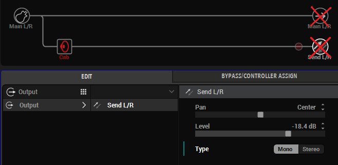

Hello, I'm trying to reamp from the send jack straight into my Marshall amp using a reactive load and taking the signal back on main input L/Mono with a CAB block inserted. I want to monitor through DAW from path B 3/4 input (disabling hardware monitoring to have timing in sync), but I'm having problems with the stomp automatically sending the signal from path B to the send output again, making a nasty loop to the amp. I just want to use path B to disable hardware monitoring and use input 3/4 in reaper (using reainsert, for the reaper users) and not making it automatically send the signal out from the 3/4 jack, is this possible? Everything sounds fine and runs fine except the timing issue (when using hardware monitoring) or the nasty loop when using 3/4.

Inserting a pic, not sure whether it or me are making any sense but I thought some of you might have any tips.
Here's a Preset and a screenshot.

Thanks for the help! I got it working, I had to also make the Send L/R block stereo, and hard pan it right and use out 3, input 4 in ReaInsert.
When using 'Split Y' the balance didn't matter if it was hard left or right, but when using 'Split A/B' it got silent when fully to L. I don't know if my brain is playing tricks on me but I think split Y and split A/B sounded just slightly different.
