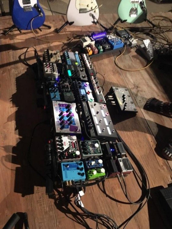

After that I wait on delivery of the ES-8 and I'm off to the races with a full redesign of my pedalboards:
Yeah, the box I linked to was just the result of a quick search, the Ghost is a much better box.
Looking at that monster board, have you seen this yet?
Looks wild, and more to come......
