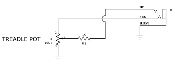

A standard TRS expression pedal circuit is like this:
When you move treadle, it varies the voltage going back the tip. The value of the potentiometer in this scheme isn't important, as it's not directly in the expression circuit.

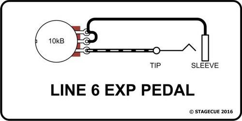

The Line 6 EX-1 and Mission Engineering EP1-L6 are wired like this:
With this scheme, the potentiometer is acting like a sink for the voltage coming from the EXP jack.
Because the ring connection is grounded on the TRS versions, I think that why some of those end up working. The voltage between the tip and the sleeve is still being varied by the treadle, but at some positions, it grounds out, so you get the jumps to 0 or 100.
