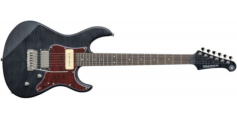

I was just curious because I have a Pacifica too. Mine's a 611VFM in translucent black. I picked it up in mint condition from a very nice guy on Ebay for only £300 inc a gig bag.
It's a cracking guitar that punches way, way above its weight with a Seymour Duncan P90 neck and Seymour Duncan bridge humbucker, Wilkinson VS50-6 bridge and trem, locking Grover machines, graphite nut and 3 way plus a push pull tone knob for single coil options. The neck is superbly comfortable with a lovely dark varnish and rosewood board, and it has a matching headstock.  The trem was set up badly when I got it, but I've set it up properly and it now returns beautifully.  It didn't come with the allen keys but I called Yamaha Music (London) and they very kindly sent me a set in a cute little holder.

Yamaha Pacifica 611VFM Translucent Black Front
That's not a bad looking axe!!!  nice score for 300...!
Thanks - these are something like £550-600 new so it was a darned good price.  It's just a good 'workhorse' guitar with a nice range of tones that's typically an everyday guitar at home. But I rotate them so the last few days I've been playing my 2009 Daphne blue USA Strat.
