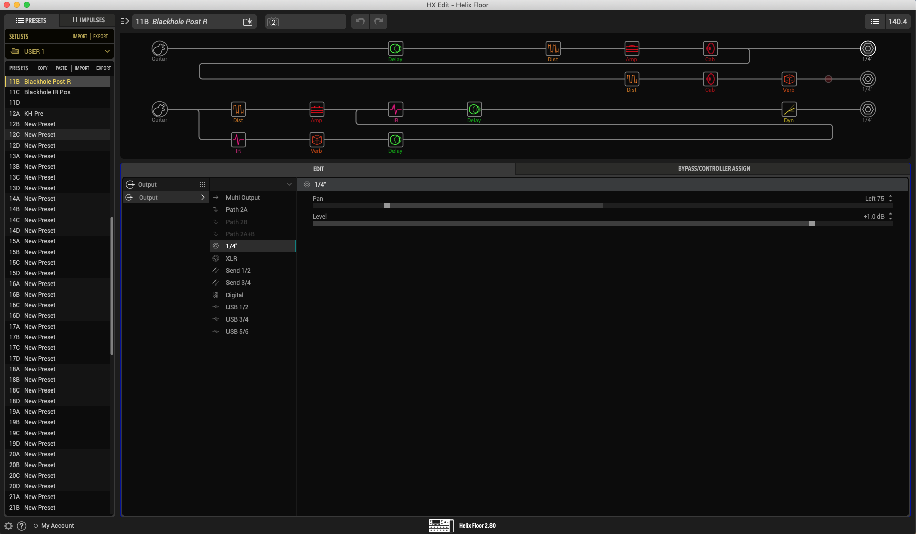

Thanks Phil, I think so too but I can't narrow it down. I have attached 3 screen shots below:
#1 - Line 1
#2 - Line 2
#3 - Line 3
If you want more images like routing in my DAW or anything else let me know

So in all these screenshots, you have all the paths' output blocks set to the 1/4" outs. Nothing would be being sent to USB 1/2. Are you saying you're changing them to USB 1/2 when recording? It also seems strange to me that you have the cab block in Path 1A feeding into another cab block on Path 1B, but that might be beside the point.

When I go to record I set the all outputs to USB 1/2.

Are your monitors plugged into Helix, or your Mac? If it's the Mac, that's problem #1. Monitors need to be plugged into Helix, even if you're recording via USB. The Helix becomes your sound card.
Second thing I see -- your patches have an amp and cab running into another cab in some cases. You also have a path with an IR running into another IR. That isn't necessarily a problem, but it's definitely unconventional and is likely to yield weird/thin tones (maybe you wanted that, though).
Tinny tones are often the result of phase cancellation, so make sure you haven't inadvertently flipped the phase of any of your paths where they merge, too. That kind of thing will sound fine through headphones, but as soon as you listen through monitors (or merge the signal to mono), it'll sound awful.
If you post your presets and IRs here, we can take a closer look and see if the issue is with your DAW or your presets.
