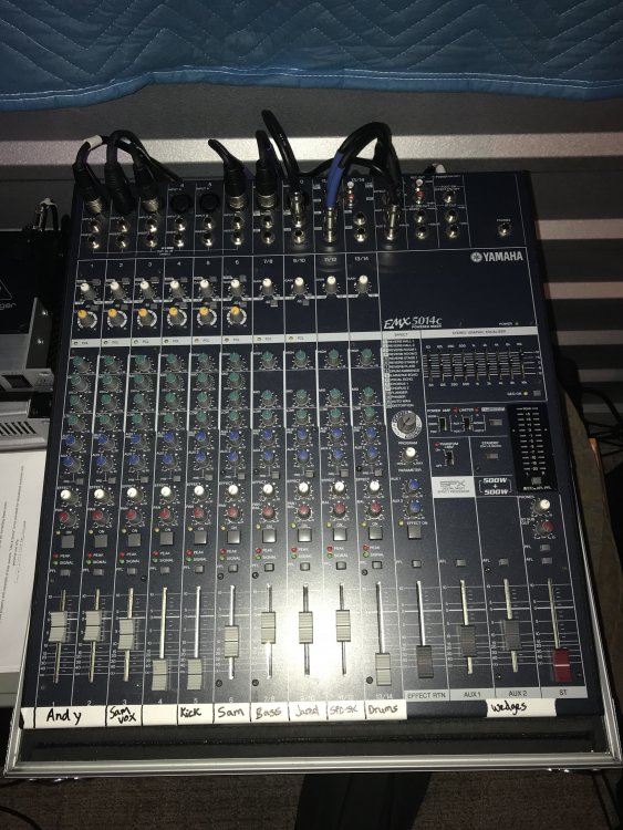

I've attached a photo for reference, I'm plugged into channel 7/8, which only has one XLR slot.  If I'm able to use just the one TRS to XLR in the mono slot, the patch with amp/cab sim will go through the mixer/PA and the amp will get pre cab/IR signal.  But if I need two cables, then I'd need two XLR slots in my mixer channel? Or would I use two channels in the mixer?
well just use one if you're fine with a mono signal. if you are using stereo effects, or you want to try stereo, plug one TRS for left and another for the right main outs, in two mixer channels and pan then hard left and right.

cristt, that makes perfect sense.  I'm new to live sound so wasn't exactly sure how that would need to be setup on the mixer, thanks!
