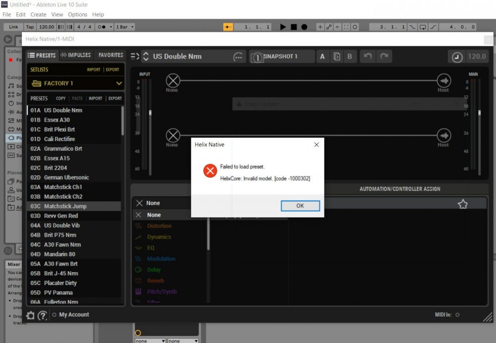

This error code appears every time I try to get any preset to run.  My laptop is a professional grade Dell.  It has 16 GB of ram.  I am running other plugin such as IK Multimedia Pod Farm and Positive Grid's BIAS FX2.  These plugins work great.  I am also able to use Helix Edit for my HX Stomp.  It is very mysterious.  Prior to trying to install HX Native 3.0 again, Helix Native 1.90 was working fine.

By "Professional Grade" I'm assuming an i7.
I'm also going to assume that you've at least checked the optimizations I mentioned, especially the processor setting, as opposed to just dismissing them because "other stuff runs".
That done, uninstall Native with the provided uninstaller.
Run a Registry checker to make sure there's no leftover related entries or other problems. I use CCleaner FREE version. Then reboot.
Download a fresh copy of Native 3.0 and re-install.
Open a NEW Project in LIVE, with just one track for Native.
If you still get the error, just for giggles, try a different DAW. Reaper has an unlimited trial.
If you get the same error in Reaper, I really don't know at that point.
I've established that Native 3.0 runs fine on much lesser and older HW, and in multiple DAWs..
Maybe check with Ableton support (and the forum) in case they've seen this before?
Good Luck!

I have Live suite 10 and Native 3.0.  I had the same issues when I upgraded.  uninstall/reinstall did not work for me.  the fix was after uninstall, I had to go through my VST folders and manually delete helix native plugins because the uninstaller didn't remove them, and the new installer didn't over-write them..  once I did this manual plugin delete... I just installed it and everything worked.. had to activate again but that was it.
  • 5 months later...
  If you have an SD card remove it from the computer.  I spent numerous hours troubleshooting the issue and was continually getting that same error message.  I very kind person from this forum suggested I remove the SD card in my laptop.  I did and Native worked fine.  It’s a flaw in how Native is designed that it crashes if an SD card is installed on a computer.
Amazing. It works whent SD off
So weird
Thanks a lot for the solution !
So weird
I absolutely don't believe...after 4 hours troubleshooting and cursing everybody at line6...I've removed the SD card and it's working.
