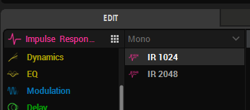

5 hours ago, bobbysm15 said:
In Helix Edit what are the numbers just below the mono tab when an IR is selected. Mine shows IR1024 and IR2048....what are these?
I think it is also important to note that those are not IR's themselves.... it chooses type of block you want, but the block will be empty.
The block itself is where you choose the IR.
