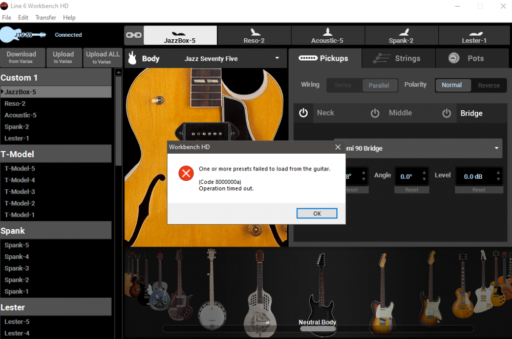

I try to launch Workbench Hd trough the Helix
Workbench launch but I have a error when scanning the presets
My presets are the Chad Huskey bundle
I try to flash the memory trough helix too with Line  6 Monkey but not working
I use a VDI cable, work pefect on Helix for changing patches etc...
WTF ?
Tx for help

Ok It's resolved
What I did:
- Connect the Variax with Usb interface
- Launch Line 6 Monkey and reflash memory with original bundle(not keeping existing preset)
- I test with the Helix and it works
- Launch Workbench with the helix and reinstall Chad Huskey bundle
 And it works
- I reinstall my  2 custom on Variax with the helix and it works
-  I close all
- Relaunch all to test and now it works
I think but not sure maybe it's because I change 4 original tuning on the  tuning knob ?
