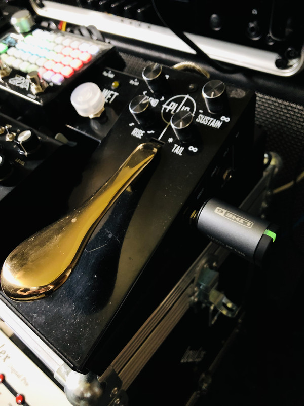

Full Charge, Full Discharge. To do so I plugged the G10TII straight out of my Plus Pedal signal SEND, to feed a continuous signal into it, and prevent the auto-standby.

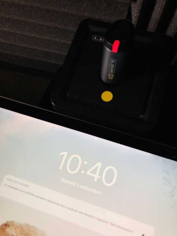

  • Charging (Red Flashing) started at 10:40 (first charge ever, out of the box)
  • Charging (Solid Green) completed at 12:18 (kept in the charger ~20 extra minutes just to be sure cycle was completed)
  • Play/Duration Test started at 12:36

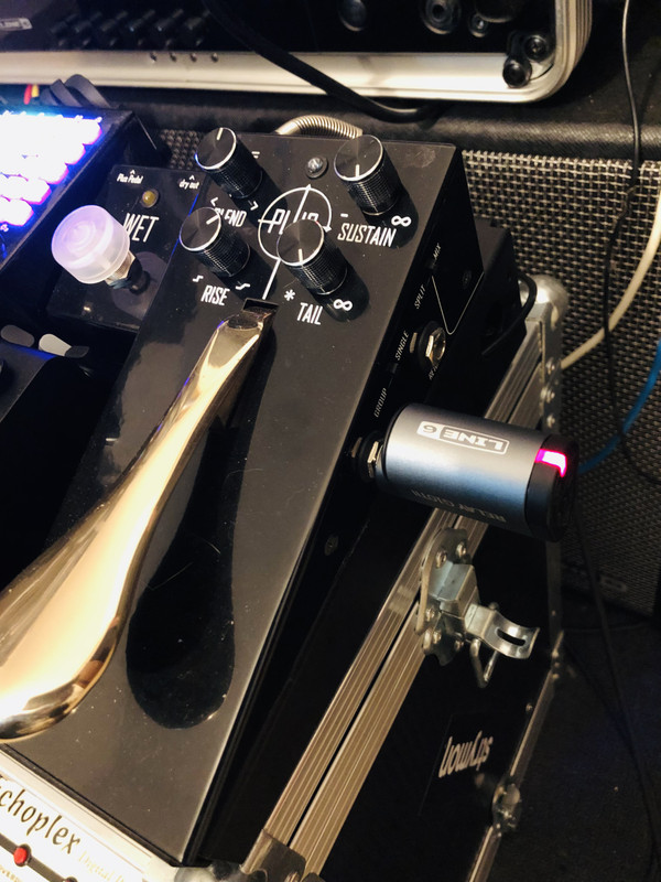

  • Play/Red Flashing started at 18:32
  • Play/Battery died at: 18:49

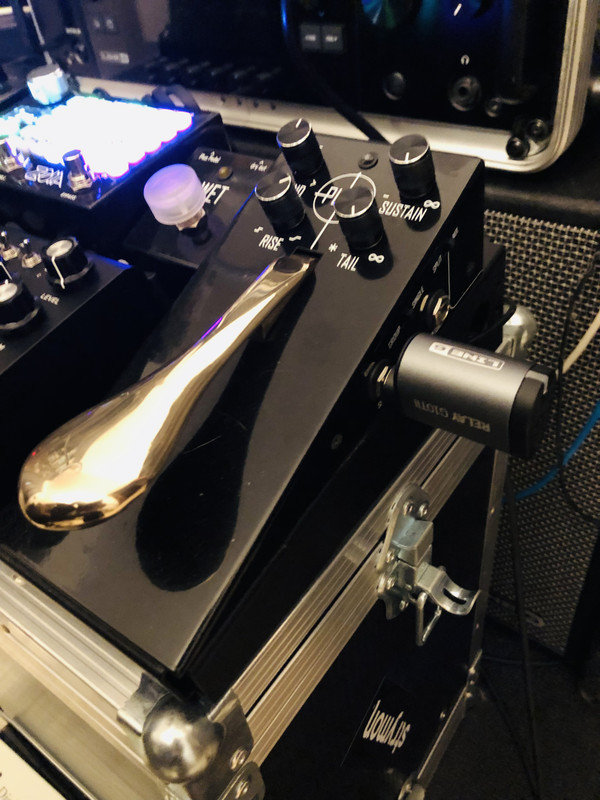

Package Front/Back;
Charge Started at 10:40
Charge Completed at 12:18
Playing Test Started at 12:36
Battery died at 18:49
